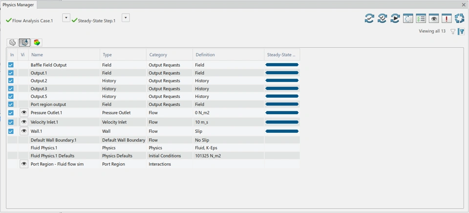

Physics Manager for Fluid Simulation:-

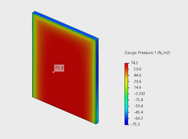

Results for Flow Simulation over a Baffle:-
Gauge Pressure
This image shows how pressure is distributed over a Baffle plate. As air flows over the baffle, pressure is highest where it's directly obstructed, then rapidly diminishes and becomes negative along the leading and trailing edges.

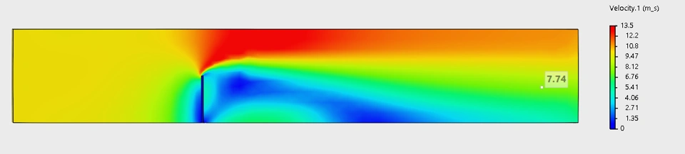

Velocity
This image presents a contour plot illustrating the velocity distribution of air flowing over a flat, thin, rectangular obstacle, likely a flat plate or a slender wall, within a channel. As the uniform yellow flow (around 10 m/s) approaches from the left, it sharply encounters the obstacle, causing the air directly in front to decelerate significantly, indicated by the dark blue region signifying near-zero velocity where the flow effectively stagnates.

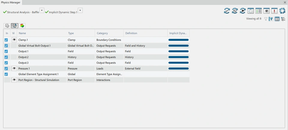

For Structural Simulation:-
Fluid-Structure Interaction works by constantly adjusting the structural response based on the fluid's influence. The fluid exerts dynamic pressure and viscous forces directly onto the solid's surface, causing the structure to deform, vibrate, or even undergo large displacements. In turn, these structural deformations modify the exact shape of the boundaries that the fluid "sees," directly changing the fluid's flow path and thus altering the forces it applies back onto the structure. This continuous, reciprocal exchange means that an FSI analysis for a structure is not static; its behavior is perpetually influenced and updated by the surrounding fluid's dynamic forces.

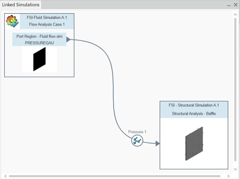

Port Region:-
The term "port" implies an access point or interface. In simulation, it's a dedicated region on the boundary of your computational domain that acts as an entry or exit point for the simulated physical quantities. It helps to abstract and simplify the complex real-world connections of your component to the larger system it operates within.

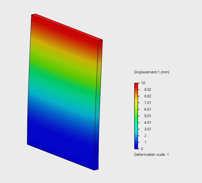

Structural Simulation Results:-
Displacement:-
This image illustrates the structural displacement of a baffle, showing it's fixed at the bottom (0mm displacement) and experiencing its maximum deflection of 10mm at the top edge, likely in response to fluid forces.

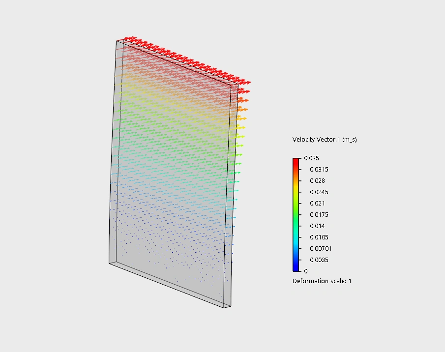

Velocity Vectors:-
The image visualizes a velocity profile where the fluid speed gradually increases from zero at the bottom (likely a fixed boundary) to a maximum at the top, characteristic of fluid flow developing along a solid surface.
