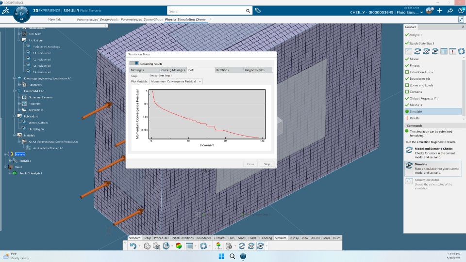

Fluid Scenario Simulation frozen at "Extracting Results"
Has anyone here successfully ran a CFD simulation using the Fluid Creation Scenario app? I'm following the course on EduSpace but with any model I run, it gets stuck at this phase. The solver runs through the iterations very quickly but it just gets stuck at preparing visualization.
I'd appreciate any help from SIMULIA experts. My Dell XPS 15 has the specs below.

This is a very common high-performance laptop used by many engineering students. I don't think the specs are that much of a problem because I can run CFD sims using other softwares. I think there's a bug with the 3DX program.
In my simulation run, I'm using all local storage, and my high performance vis is also set to local
The exact tutorial I'm following is W8 - Steady-State External Flow over a Drone in Cruise from
Learning Modules 3DEXPERIENCE R2022x Fluid Simulation Essentials
