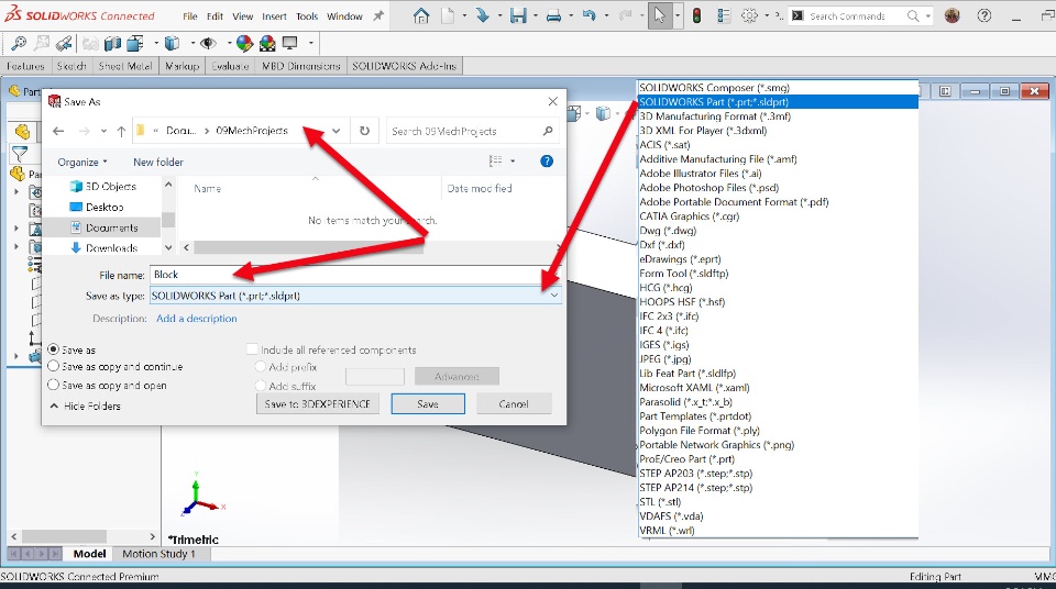

By default, in the 3DEXPERIENCE SOLIDWORKS native app, your SOLIDWORKS data is saved to the 3DEXPERIENCE platform (cloud). With the FD07 release, you can save SOLIDWORKS parts, assemblies and drawings to your desktop with File> Save, Save to My PC. Select the correct file format. Note at this time SOLIDWORKS Composer is the default file type. For a part, select Part, .sldprt.
To open a SOLIDWORKS file saved to your Windows PC, select File>Open. From Windows, browse to select the part, assembly or drawing. From the 3DEXPERIENCE window, Select Open from My PC button on the lower left corner and browse to the correct folder.
