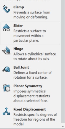

6. Provide Restraints-
  • Restraints are used to restrict the motion of certain surfaces in your model.
  • Restraints fix translational or rotational degrees of freedom on portions of a model during a simulation.
  • Here we have used clamp restraint.
  • Here are all other types of restraints.

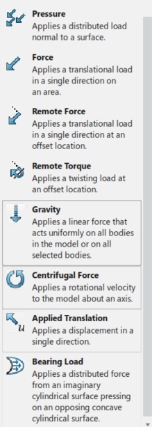

7. Apply Loads-
  • A load can represent any number of external influences on your part.
  • Here we have applied Force of  2000N on the pedal.
  • Here are the types of Loads.
