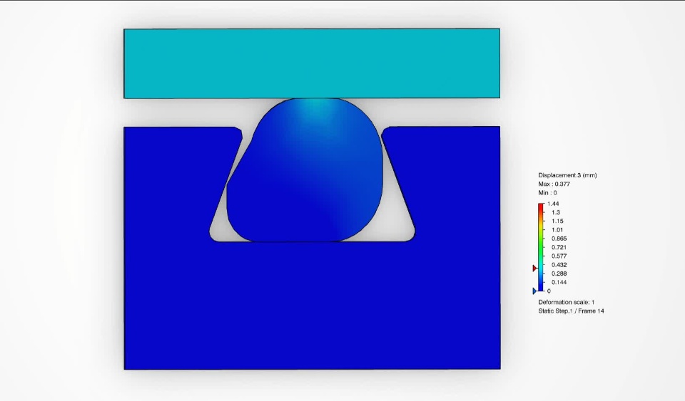

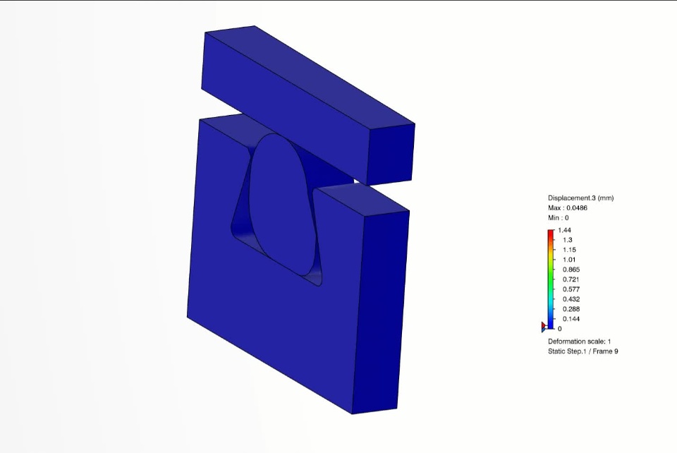

In this simulation, I have performed the static simulation for 'O-Ring'.
The main step in this simulation is to create the hyperelastic material and assigning it to the O-Ring.
The analysis step is performed using the Mechanical scenario creation app.

7. Exploring the results
You can refer the above simulation on User assistance R2023x
