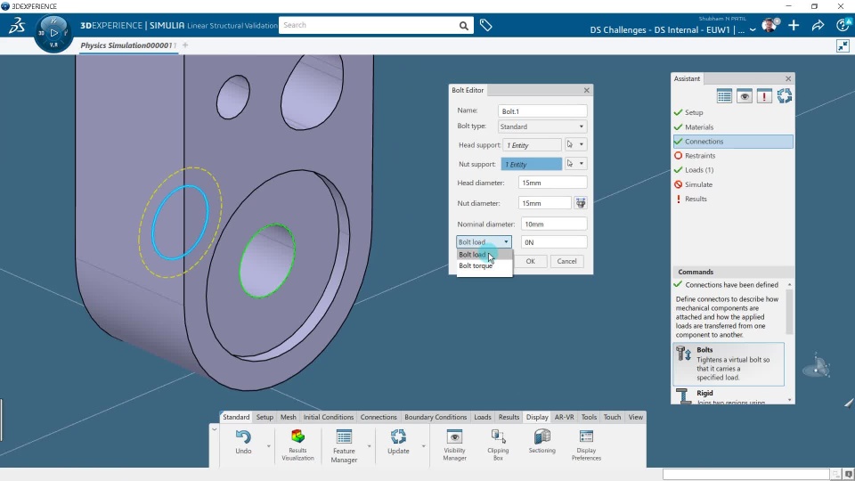

Bolted connections are a type of structural joint used to join two or more structural components in a structure using bolts. Bolts are a form of threaded fasteners which has a male thread and preformed matching female thread, such as nuts.
About Virtual Bolts (👈 Click here to know in detail )
Before you proceed with the simulation, you must know the below-given information to set up a simulation closest to the practical condition.
- Standard, Countersunk, and Tight-Fitting Bolts
- Bolt to Ground
- Intermediate Layers
- Template Files
- Bolt Replication
- Automatic Detection
- Bolt Loading
Defining Bolts (👈 Click here to know in detail )
To know about how to create bolted connection, click the above title.

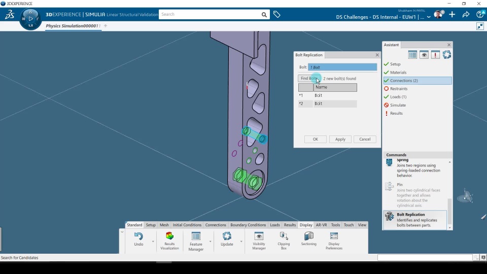

Replicating Virtual Bolts (👈 Click here to know in detail )
You can generate copies of an existing bolt at other holes in the model. Which will save a lot of time of creating each bolt individually.
📢 Here is a quick video on how to replicate the bolts.
