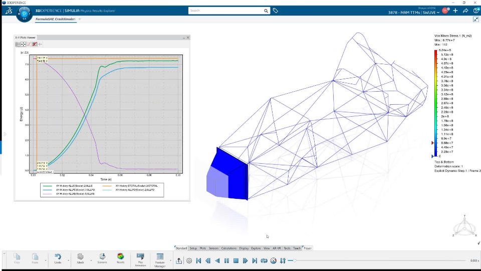

Last year I presented during a SOLIDWORKS LIVE event showcasing a crash test simulation using Structural Mechanics Engineer role on the 3DEXPERIENCE Platform. Below is a quick results animation from the simulation
Following are some key points I cover during this presentation:
1. Geometry preparation - Splitting the beams to create a node-to-node connection
2. Creating beam profiles
3. Beam meshing considerations
4. Connecting beams, shells and solids
5. Element type assignment for linear brick elements
6. Material Calibration
Here's a link to the YouTube event if you want to catch up on some advanced simulation over the weekend: https://youtu.be/KdULOl8nPYw
