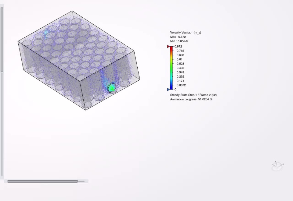

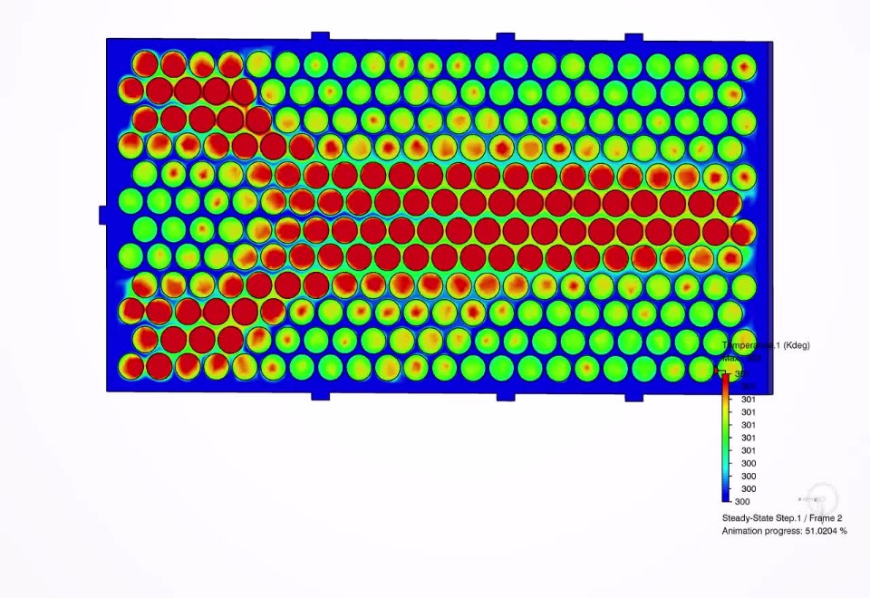

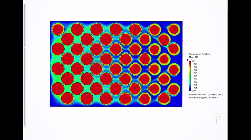

8. Exploring Results:
After the simulation, the results will be loaded on-screen automatically.
We can change the Scale factor from the contour plot.
We can explore various results like Temperature, Pressure, and Fluid velocity. Also, we can see the min and max values of the various factors across the geometry
For the ease of viewing the results of various parameters at a particular point, we can take the section view.
We compared different arrangements of cells and the results helped us to choose the most effective arrangement. We manufactured and assembled the battery pack and performed experiments on it and the results shows a close resemblance with the simulation results.
