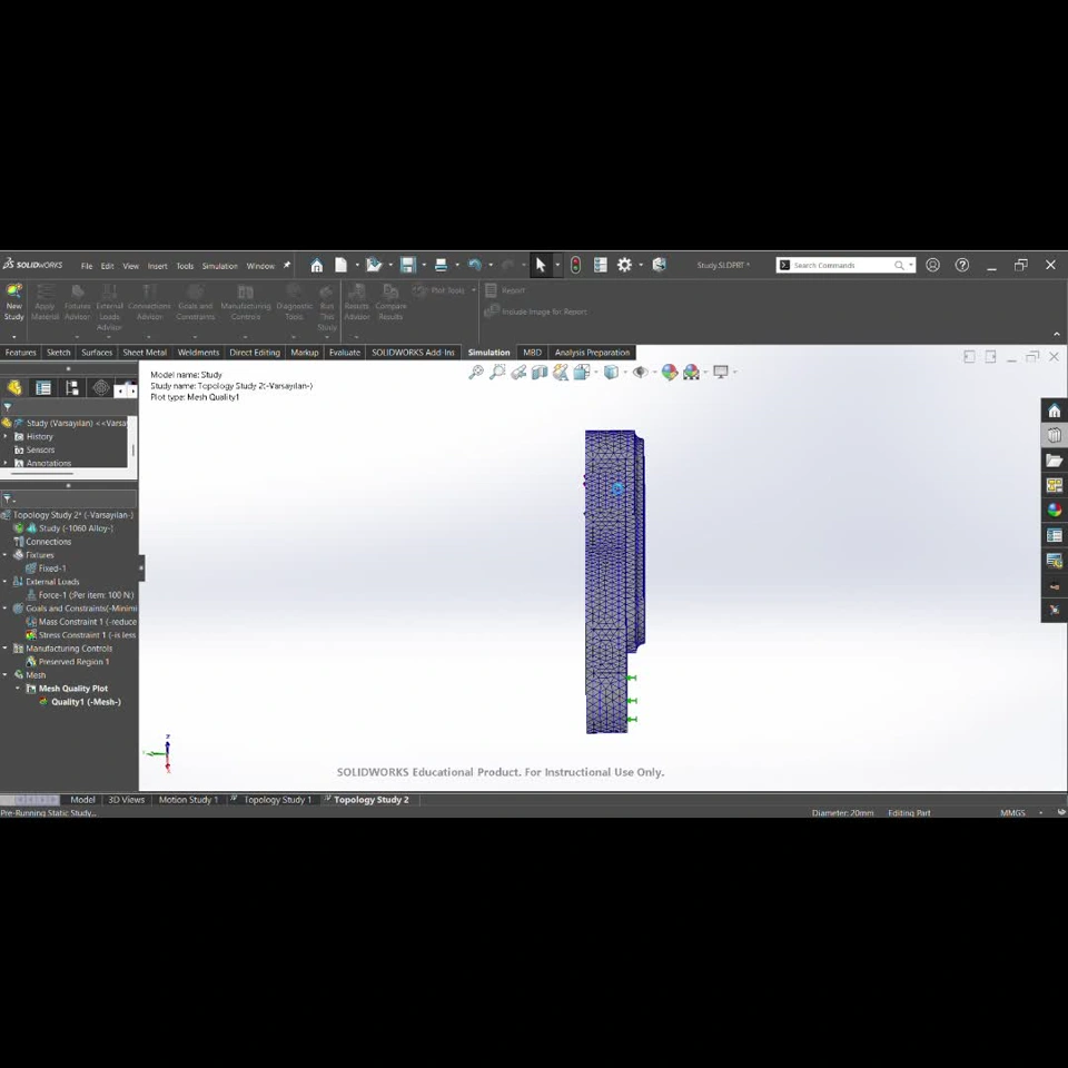

I’m excited to share my recent tutorial where I performed topology optimization on a robotic arm link using 1060 Aluminum Alloy, under a 100 N load using SOLIDWORKS and 3DEXPERIENCE Edu from Dassault Systèmes.

⚜️ Step-by-Step Topology Optimization in SOLIDWORKS
  1. Create Topology Study --------> Open a new Topology Study.
  2. Material Selection ---------------> Assigned Aluminum 1060 Alloy
  3. Apply Fixtures --------------------> Fixed one end to simulate the mounted base of the link.
  4. Apply Load -------------------------> Applied a 100 N force to the opposite end to represent operational stress.
  5. Define Goals  ----------------------> to goal Minimize mass and set preserved regions to maintain interfaces or bolt zones.
  6. Meshing -----------------------------> Generated a fine mesh for higher accuracy and resolution.
    ➡️Run the Topology Optimization
    SOLIDWORKS analyzed low-stress zones and suggested material removal.
    ➡️Result Interpretation
    Reviewed the optimized material layout. Exported the result and remove all unnecessary area
