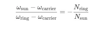

The fundamental equation for epicyclic gear systems is derived from the relative motion of the components:
Where:
  • ωsun​, ωring​, ωcarrier​ = angular velocities of the sun gear, ring gear, and carrier, respectively.
  • Nsun, Nring = number of teeth on the sun gear and ring gear, respectively.
The negative sign indicates opposite rotation directions.

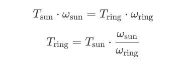

Torque Distribution
Torque distribution depends on the gear ratio and the power flow. The torque on each component can be calculated using:
Where T is torque.

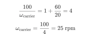

Case 1: Ring Gear Fixed
  • Fixed Component: Ring Gear (ωring​=0)
  • Input: Sun Gear (ωsun​=100 rpm)
  • Output: Carrier (ωcarrier​)

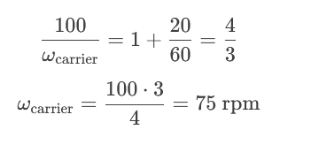

Case 2: Sun Gear Fixed
  • Fixed Component: Sun Gear (ωsun​=0)
  • Input: Ring Gear (ωring​=100 rpm)

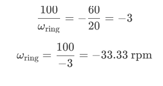

Case 3: Carrier Fixed
  • Fixed Component: Carrier (ωcarrier​=0)
  • Output: Ring Gear (ωring​)

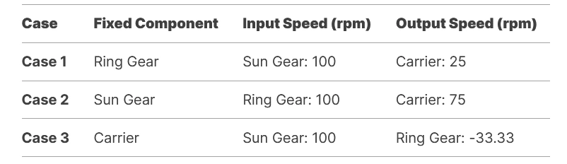

Summary of Speeds

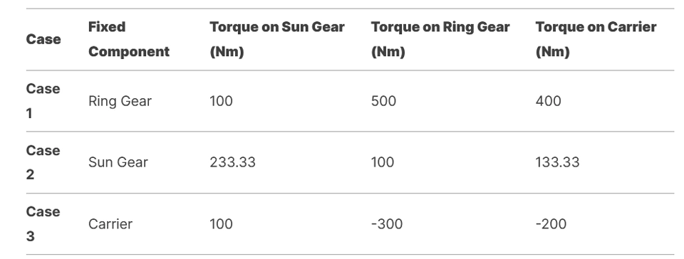

Assume the input torque is (100 Nm) the torque calculation will be:
  • Fixed Component: Ring Gear (0ωring​=0)
  • Output: Carrier (ωcarrier​=25 rpm) (from earlier calculation)

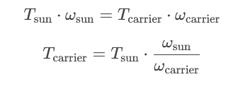

Torque Relationships:
The torque on the sun gear (Tsun​) and carrier (Tcarrier​) are related by:
Torque on Ring Gear:
Since the ring gear is fixed, it reacts to the torques on the sun gear and carrier. Using equilibrium:
  • Output: Carrier (ωcarrier​=75 rpm) (from earlier calculation)

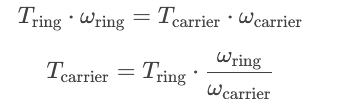

Torque on Sun Gear:
Since the sun gear is fixed, it reacts to the torques on the ring gear and carrier. Using equilibrium:
  • Output: Ring Gear (ωring​=−33.33 rpm) (from earlier calculation)
Torque on Carrier:
Since the carrier is fixed, it reacts to the torques on the sun gear and ring gear. Using equilibrium:
Summary of Torque Results
