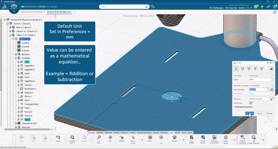

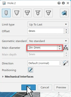

Did you know that entering values in 3DEXPERIENCE is very flexible? It takes different units and also mathematical equations!
You don't need a separate calculator or unit convertor, you can enter the equation directly in the value field and 3DEXPERIENCE will calculate it for you!
And of course, you can also change the default units to suit your needs, anytime!
