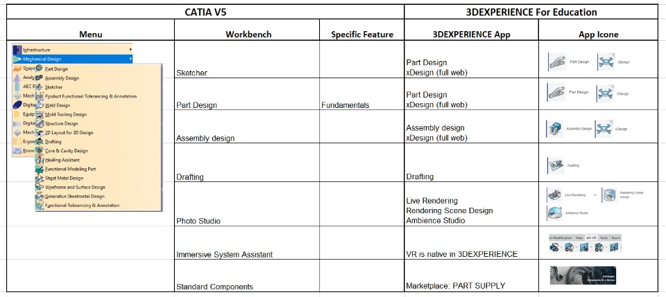

To make this transition journey simpler, we have created a table that you can refer. Here, you can find the 5 basic workbenches you regularly used in V5 and find the associated app with symbol in 3DEXPERIENCE.
Just click the compass icon on the top-left (it’s our “AppStore”) and drag them from My Apps section to the My Favorites section.
Here’s the mapping table that can help you:
