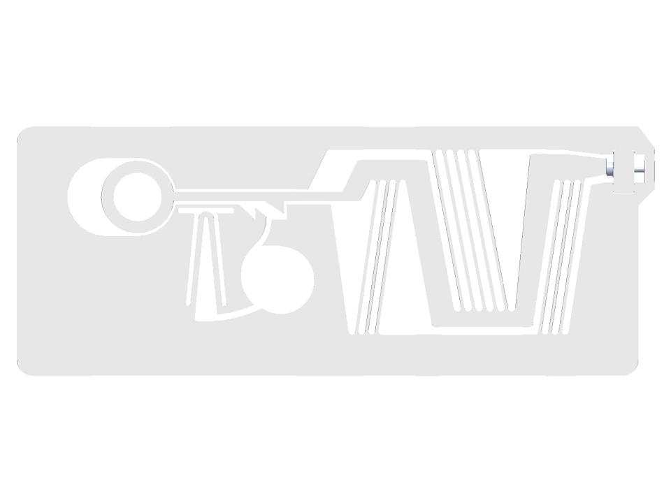

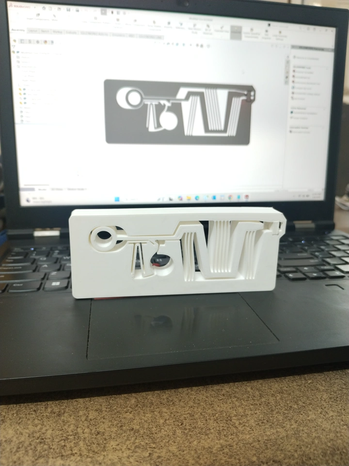

My Project: I designed a compliant mechanism using SOLIDWORKS and brought it to life with a 3D printer. This project demonstrates how elastic deformation can be utilized to design efficient and durable mechanical systems.

Working of Mechanism:
To engage the trigger with the extension of a rigid link, the circular end of the link is pulled until it engages with the hole.
Once engaged, the flexible links undergo elastic deformation, bending rather than breaking due to their reduced thickness. These links function as compliant springs, storing and releasing mechanical energy efficiently.
Upon releasing the trigger, the stored elastic energy in the flexible links restores them to their original configuration. This controlled deformation facilitates a straight-line motion transfer to the rigid link, ensuring smooth and precise mechanical operation.
