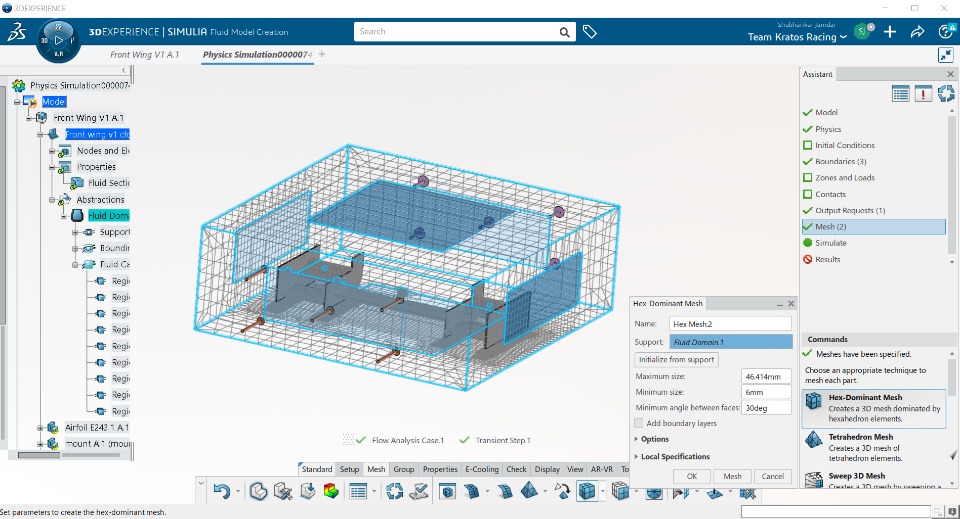

The adaptive Hex-dominant mesh really helps to bring out the exact model shape through to the simulation window, as the mesh at the critical parts, regions is made more refined compared to the intermediate regions. I have experienced that for the initial iterations to check the flow, the Realizable k-Epsilon turbulence model is the best, we get the simulation based aero-maps which can be used to further improve the model and proceed with the project.

Adaptive Meshing window to bring out the exact shape of the model.

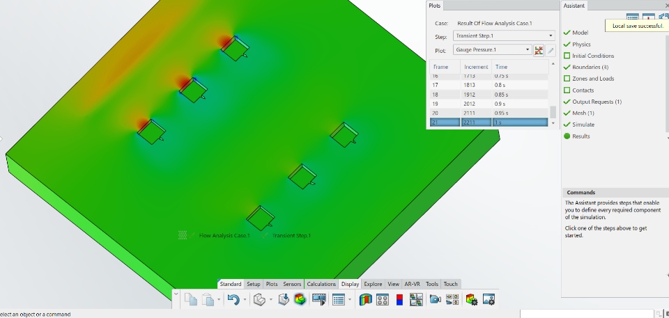

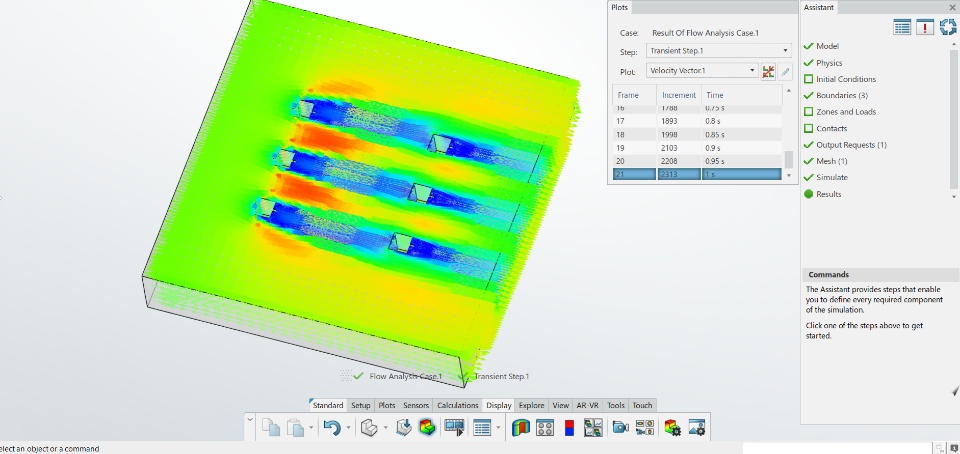

A test model to validate the flow regime concepts. Velocity vectors for transient step simulation in post-processing
A test model to validate the flow regime concepts. Pressure distribution for transient step simulation in post-processing
