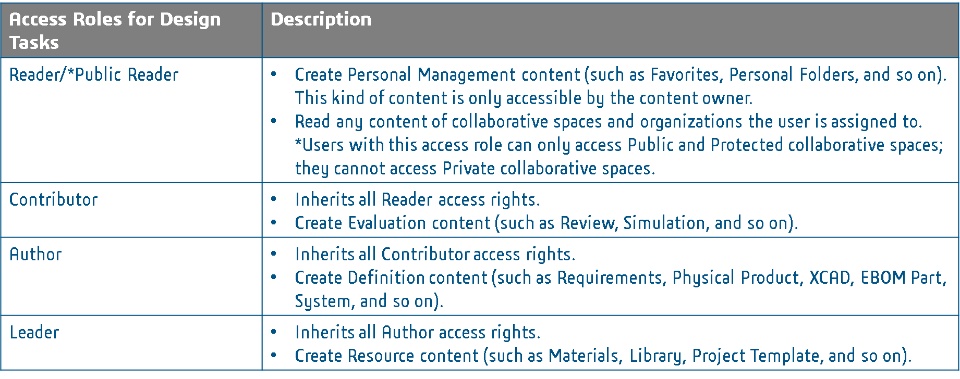

This table describes the access privileges for design tasks.

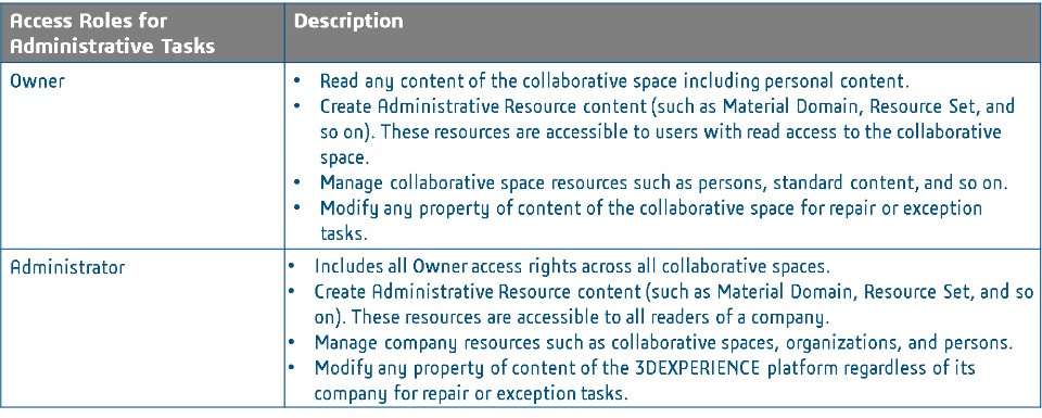

This table describes the access privileges for administrative tasks. These roles cannot create content as described in the above table (for Design tasks).​​​​​​​
