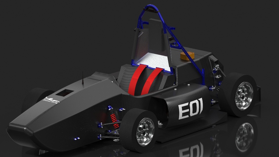

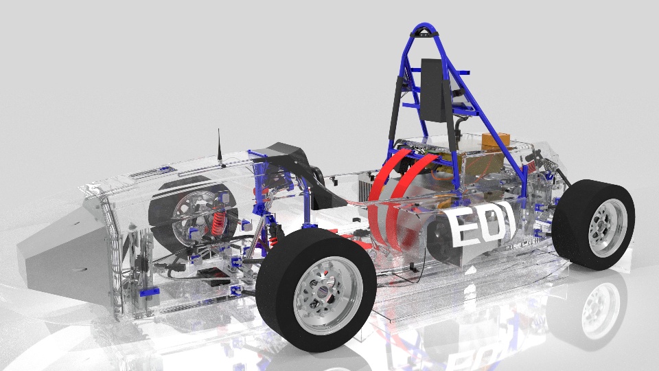

Here are the rendered images of our project:
