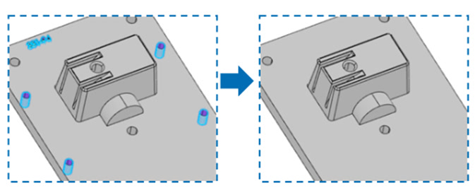

Defeaturing:
This tool is used to cleanup unnecessary logos, fillets, holes, drafts and chamfers from your models.
- You can use this tool to clean up unnecessary logos that have no role in the structural simulation and will instead cause discrepancies in meshes. Likewise, fillets, holes, drafts and chamfers from your model.
- Instead of individually removing them, you can specify a filter and rest will be taken care off by the .
For example, you can create a fillet filter to remove all fillets within a radius range.
Note: Other filters: Diameter range for holes, size range for logos, chord length for chamfers, angle range for drafts.
