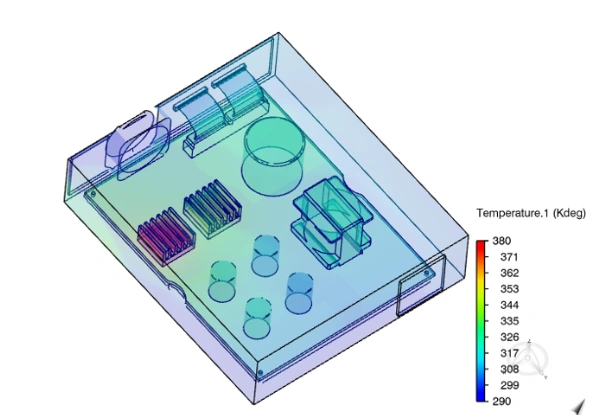

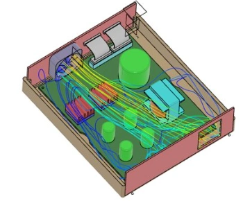

📌 Example Use Case:
Simulating heat transfer from an electronic chip mounted on a PCB. As the chip dissipates power, heat is conducted through its body and transferred to the surrounding air via natural convection—a result of temperature-induced density variations in the fluid.
💡 Technical Highlights:
  • Thermal analysis uses a heat transfer step to model conduction in solids.
  • Fluid flow is captured via an incompressible flow step that solves the energy equation.
  • Interface boundaries (e.g., top surface of a chip) are defined to link the thermal fields between the solid and fluid domains.
  • Native CHT handles conformal and non-conformal meshes, though it performs best when mesh sizes across interfaces are comparable.
