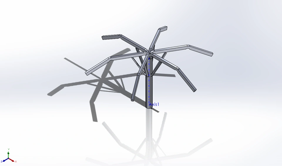

I've always been fascinated by compliant mechanisms — those elegant mechanism, joint-free systems that use flexible materials to achieve movement. They reduce part count, minimize wear, and often result in sleek, innovative designs. So, I thought, why not try applying this approach to an everyday object like an Umbrella?
Spoiler Alert: It didn't work out as planned. 😅
Below are the three models I developed, each aiming to achieve a functioning compliant umbrella. Here’s what happened:
Model 1: Initial Concept
Design Intent: I started with a basic configuration to explore how compliant ribs might flex to create the opening and closing mechanism.
Challenges: The flexibility of the arms was inconsistent, causing uneven motion. Additionally, the material stiffness was difficult to balance either it was too rigid to flex or too flimsy to support the canopy.
Model 2: Reinforced Structure
Design Intent: To address stability, I added reinforced joints while trying to maintain a compliant structure.
Challenges: The reinforcement compromised flexibility, essentially bringing it closer to a traditional jointed design. The added complexity also defeated the simplicity that compliant mechanisms aim for.
Model 3: Flexible, Streamlined Design
Design Intent: I attempted a more minimal design with slender, curved ribs to maximize flexibility while maintaining tension.

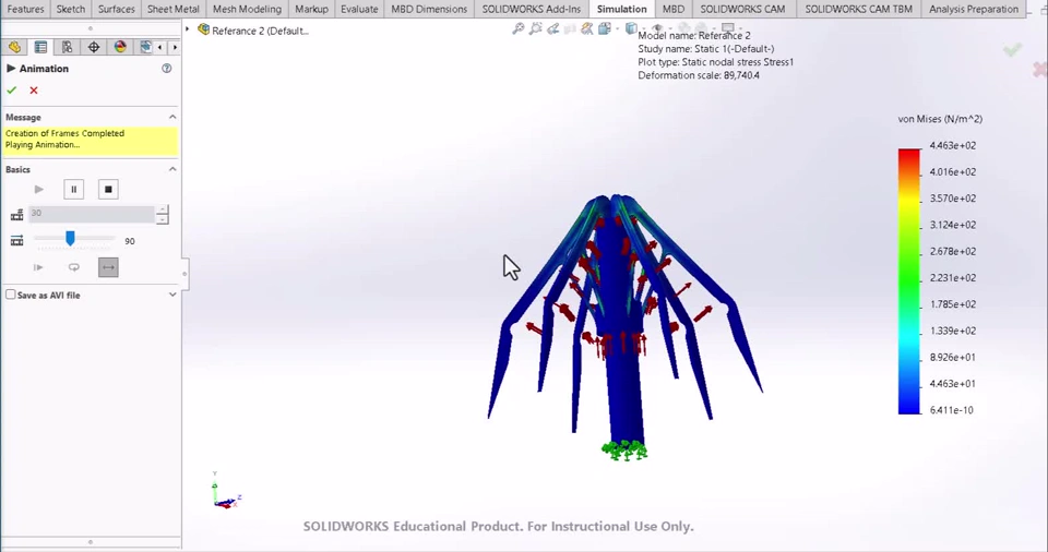

Simulation Analysis:
I ran a simulation to observe the dynamic behavior of this model.
Watch Simulation Video :
Results: The simulation highlighted the main issues — the arms had better motion range, but they couldn't handle external forces like wind pressure effectively. Material fatigue was still a concern, and the compliant structure struggled to maintain stability under load.
Key Takeaways :
  • Material Challenges: It's hard to find materials that are both flexible and strong enough for everyday use.
  • Handling Forces: Traditional designs can handle wind well, but these flexible designs couldn't stay stable.
  • Movement Range: A wide, stable spread is important. These designs couldn't create the right tension.
  • Design Complexity: Compliant mechanisms seem simple, but making them work effectively is tricky.
Final Thoughts :
This experiment reminded me that compliant mechanisms aren't always the answer. The balance between flexibility, strength, and wear makes them tough to use in some situations.
But hey, failure is part of the process! Designing, testing, and learning from mistakes help us grow as creators. Just because this idea didn't work out doesn't mean the next one won't.
Have you tried designing with compliant mechanisms before? What worked for you? I'd love to hear your thoughts!
