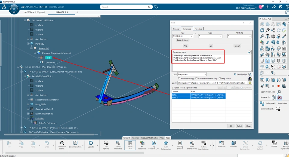

During the design process, is it possible to lose the link between parts due to different causes (in this case, the symmetrical part done with the AIRBUS method). This was happening due to the deletion of the original body.
If you have several objects in this situation, you can quickly find them using a search query like the one in the attached image. In my case, I also wanted to exclude the Flat View for sheet metal parts (also the AIRBUS method).
