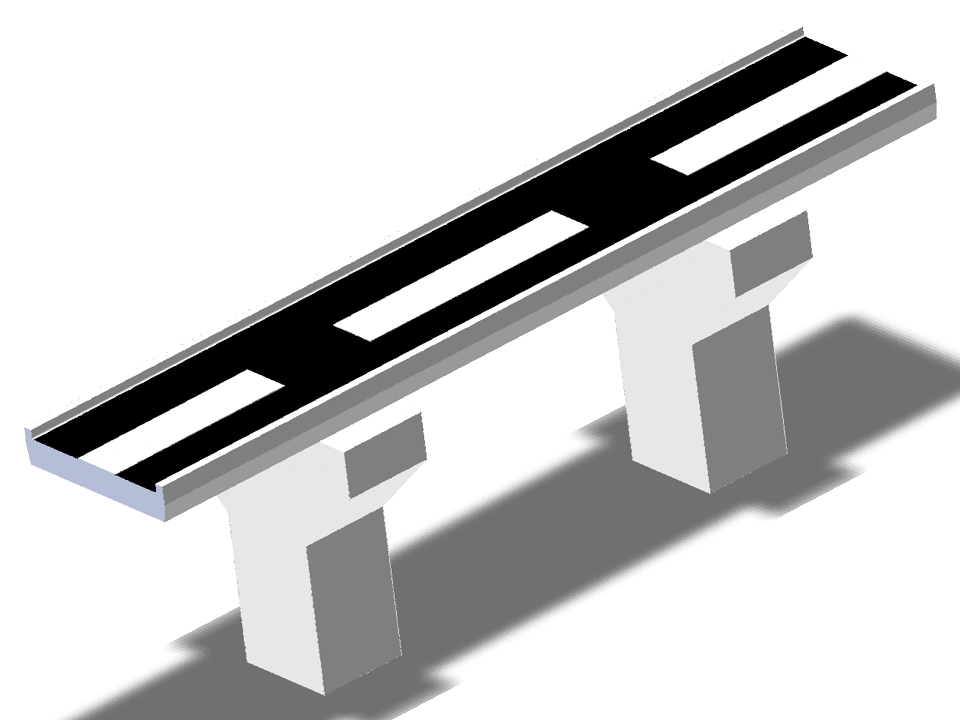

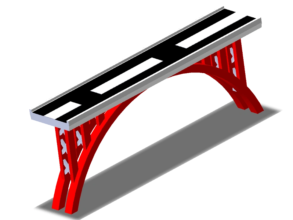

Arch Bridge
Beam Bridge

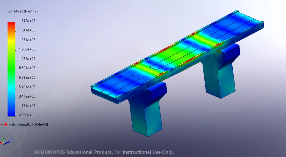

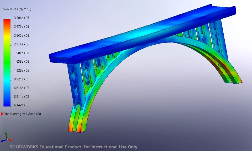

💡 In my SOLIDWORKS simulations, I could clearly see how:
  • Arch Bridge → The curved shape naturally pushes the load into the supports (abutments) at both ends. This reduces bending in the bridge and makes it strong enough to handle heavy loads and longer spans.
  • Beam Bridge → The straight beam takes the load mainly through bending. The top side gets compressed while the bottom side is stretched. Because of this bending stress, beam bridges can’t be made very long and are better suited for shorter spans.
