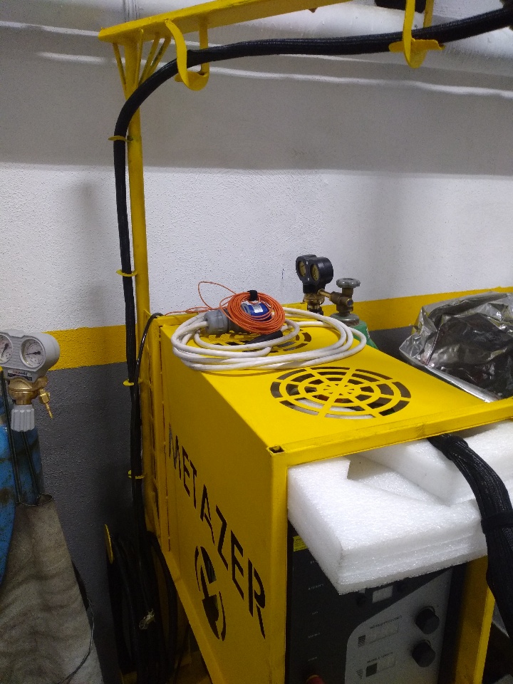

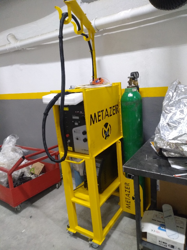

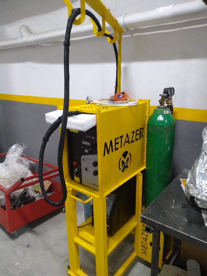

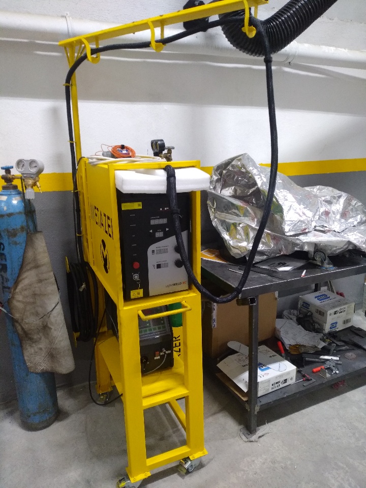

I would like to provide you with information about this practical desk that I have designed.
I have designed a specialized portable desk for our workshop's new laser welding machine. This desk is built to accommodate the laser welding machine, the wire feed unit, and the gas cylinder. Additionally, I have integrated a 360-degree rotating crane system. This crane system is designed to prevent the fiber optic cable from falling to the ground and getting damaged.
To ensure smooth movement of the fiber optic cable without any hindrance, I have also included a broad hanger in the design. With this hanger, you can neatly hang the excess part and facilitate the process.
Furthermore, thanks to the 360-degree rotating and lockable wheels on the desk, you can now easily carry out welding processes at any point in the workshop.
This design has made laser welding processes in our workshop more efficient and convenient. If you have any questions or feedback, I would be more than happy to listen. Thank you!
