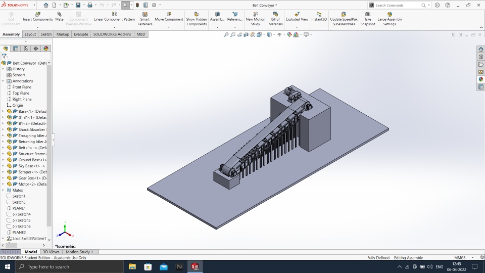

NOTE: To create the CAD model of my design I had to cut the conveying length to 9m because 90m length contains so many idlers, and bearing. My system was unable to handle so many components.
