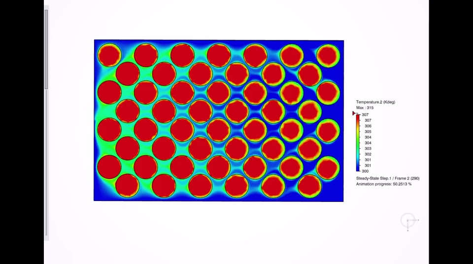

CFD Simulation:

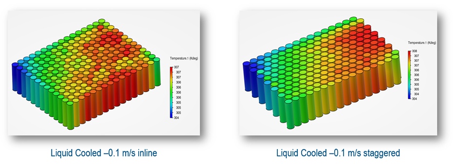

The main motto behind the simulation was to select the arrangement for cells and placement of inlet and outlet to achieve uniform and maximum cooling. The staggered arrangement and the linear cells arrangement was simulated, wherein the staggered arrangement was more effective but for ease of manufacturability the linear cell arrangement has been selected.
Then all the simulations was performed on the liner arrangement to analyze the effect of inlet fluid velocity on the cooling. The heat patches and their location was analyzed. The procedure that we followed is as described below:

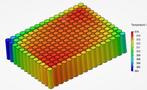

8. Exploring Results:
After simulation the results will be loaded on screen automatically.
We can change the Scale factor from the contours plot.
We can explore various results like Temperature, Pressure, and Fluid velocity. Also, we can see the min and max value of the various factors across the geometry
For the ease of viewing the results of various parameters at a particular point, we can take the section view.

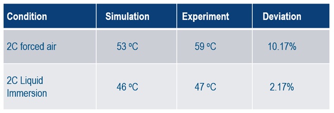

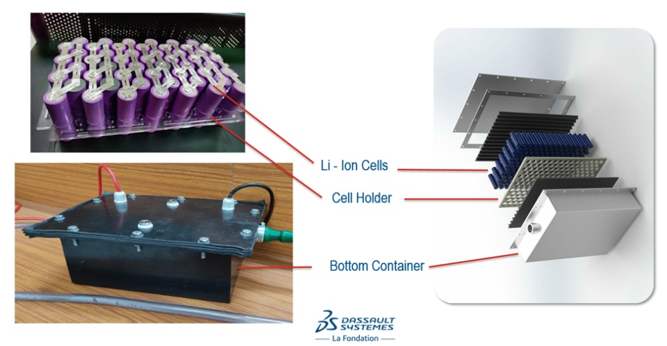

We compared different arrangements of cells and the results helped us to choose the most effective arrangement. We manufactured and assembled the battery pack and performed experiments on it and the results shows the close resemblance with the simulation results.
