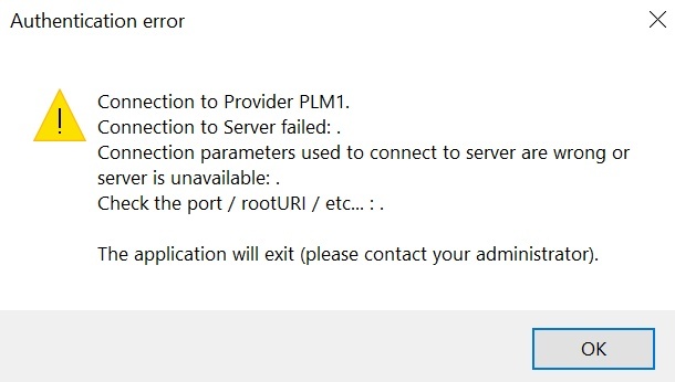

Are you getting this "Authentication error"? No worries!
This means you need to create your Collaborative Space. Don't stress! It's easy.

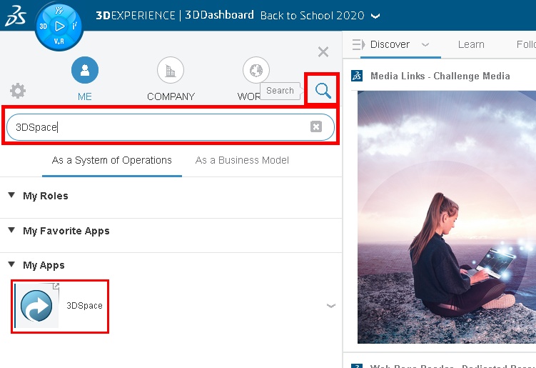

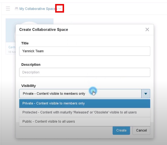

Use the compass to locate the 3DSpace app and then click on the little arrow next to "My Collaborative Space" to actually create your Collab Space.
Find the 3DSpace app
Use the arrow by "Collaborative Space"
