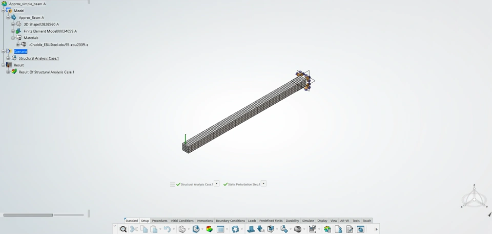

Prerequisites of establishing a surrogate model:
1. Solve an FE Analysis with Geometric Parameters:
Parameters for Length(Len), Breadth(BR) and Extrusion (ext)

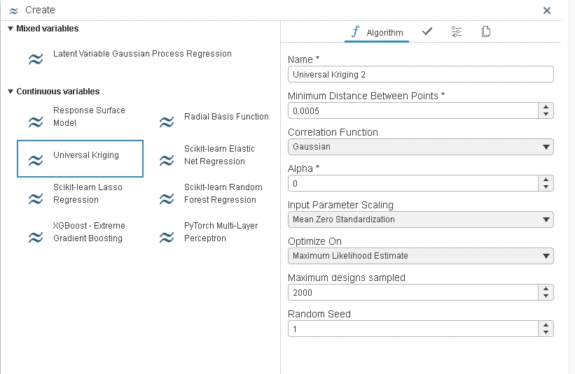

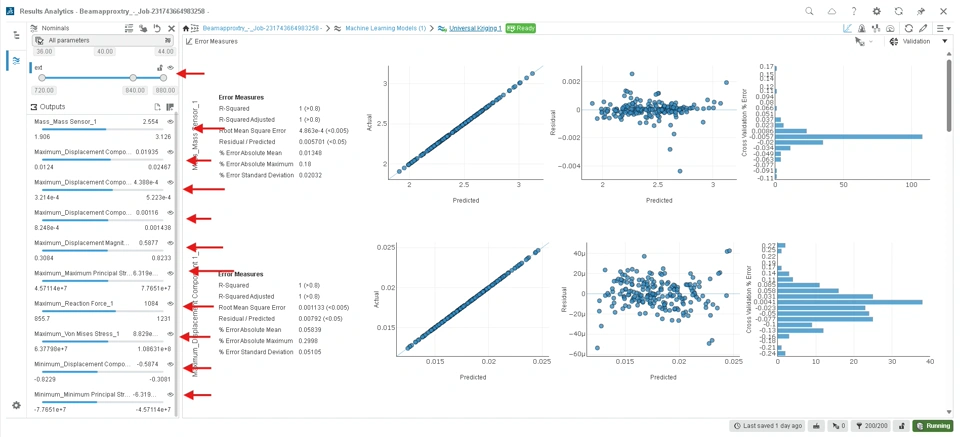

2. In the Optimization Process Composer app, a structured process is constructed to execute a Design of Experiments (DOE), generating a representative set of input-output pairs across the design space. The resulting numerical data feeds directly into a Machine Learning Model training pipeline, where surrogate modeling techniques such as Response Surface Modelling (RSM) or Universal Kriging (UK) are applied to approximate the underlying response behavior.
To enhance predictive accuracy, hyperparameter tuning is integrated into the workflow, employing optimization strategies to minimize the mean approximation error (e.g., Mean Squared Error or Root Mean Squared Error) of the surrogate models.
Once the surrogate model is trained and validated, it is made accessible within the Results Analytics App, enabling advanced post-processing, visualization, and sensitivity analysis using the approximated response surfaces.

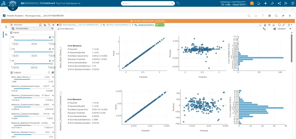

3. SIMULIA Results Analytics App
🔍 1. Data Extraction from ABAQUS Simulations
  • Physics Results Analytics app allows you to visualize and extract results (e.g., displacements, stresses, temperatures) from simulation outputs.
  • It supports efficient post-processing of large datasets—perfect for building surrogate models from a batch of simulation runs.
📊 2. Create and Analyze Datasets
  • You can aggregate simulation results from multiple runs (DOE samples).
  • Physics Results Analytics app helps in creating custom result metrics that can be used as outputs in the surrogate model.
  • Supports filtering, grouping, and comparison across different parameter combinations.
🧠 3. Link to Surrogate Modelling Tools
  • Once the simulation data is extracted and prepared, PRA integrates seamlessly with tools like Isight, 3DEXPERIENCE Process Composer, or even external Python/ML tools.
  • You can use this clean, organized dataset to train your response surface models, kriging, neural networks, or other surrogate types.
📈 4. Perform Sensitivity & Correlation Analysis
  • PRA includes built-in tools to analyze parameter sensitivities and correlations—helpful for feature selection before surrogate model training.
  • This guides you in focusing on the most influential inputs, improving model accuracy and reducing complexity.
🖥️5. Pre-process training of the model with ease
Preprocessing the model's training

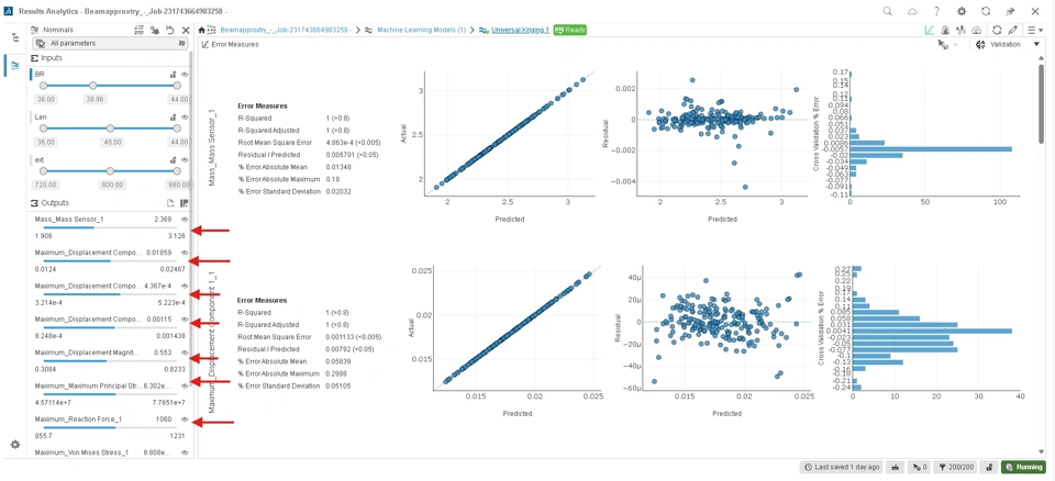

Dashboard of Approximation model
The Approximation model's dashboard can be used this way:
Turning the breadth (BR) slider to 38.96
Chaning BR (breadth) value to 38.96
The FEA sensor output values update within 2 seconds with updated values.
Next, I will change the "ext" parameter while resetting the "BR" parameter.
changing the "ext" parameter to 840
The Mass and Displacement values update within 2 seconds.
All in all, we see that without actually going into CAD and FE apps on the platform, we get instant results of the FE analysis, saving time and eliminating repetitive workflows.
