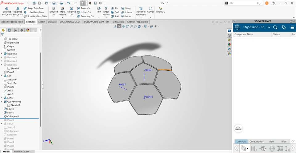

2. CAD Modeling & Material Layers

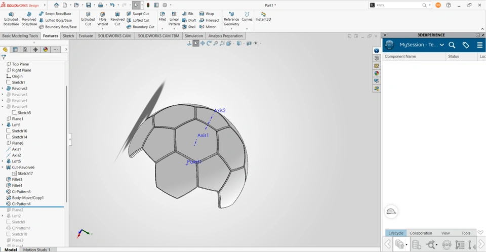

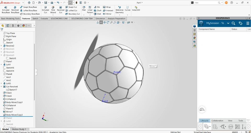

Building a mathematically perfect Truncated Icosahedron required careful geometric planning. I established core axes to define the precise dihedral angles between the pentagonal and hexagonal faces, generating surface lofts for the primary panels.
Creating the deep seam channels the primary aerodynamic drivers was crucial. I utilized revolve and cut features, then used a circular pattern to generate the solid bodies for the full sphere.

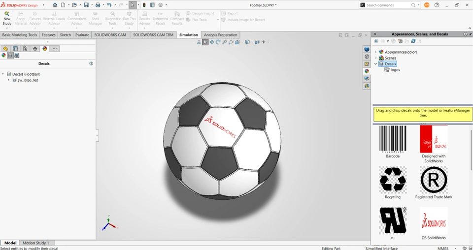

Material Specifications: To accurately represent a match ball, I modeled strictly to FIFA Size 5 regulations (220mm diameter, 1.5mm seam depth). While modeled as a solid body for this external CFD test, a real ball consists of distinct layers:
  1. Outer Casing: Polyurethane (PU) synthetic leather (resists water absorption and wear).
  2. Lining: Multiple layers of polyester/cotton fabric bonded with latex adhesive (provides structure and bounce).
  3. Bladder: Butyl or latex rubber (holds air pressure).

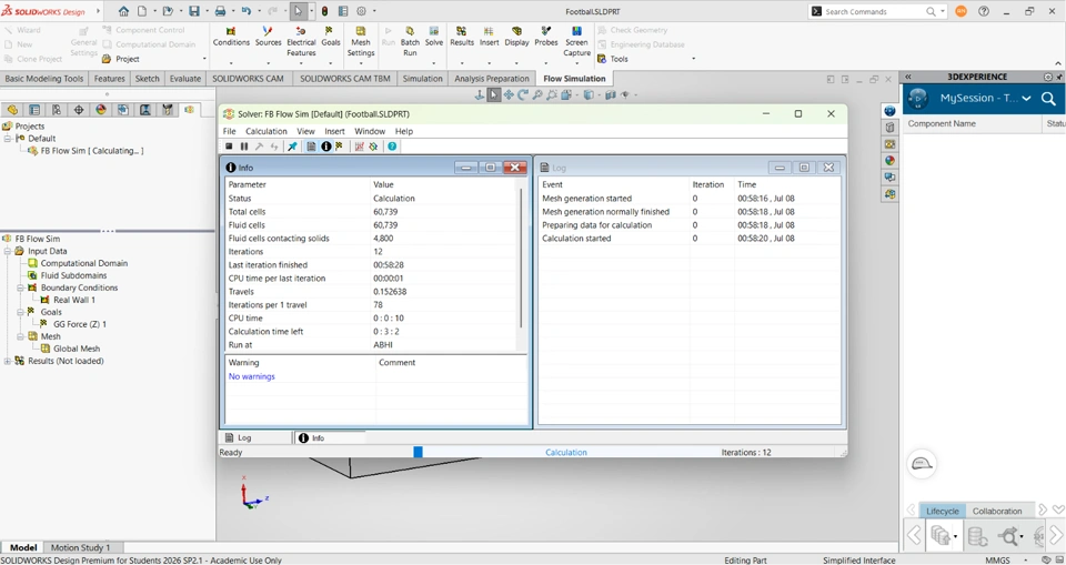

3. CFD Setup & Mathematical Validation

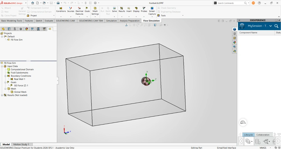

To mimic a real-world free-kick at 108 km/h (30 m/s) with heavy spin, I expanded the computational domain and set the boundary conditions.

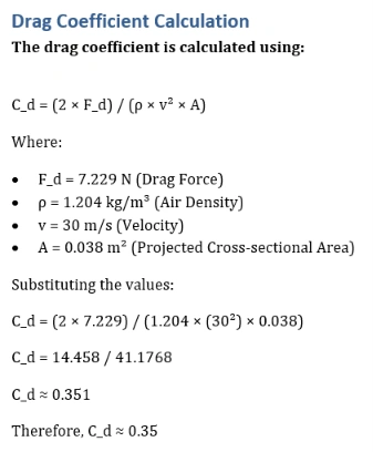

The Calculation: My SOLIDWORKS Goal Plot resulted in an Averaged Z-Axis Force (Drag) of 7.229 Newtons. To prove this design is aerodynamically sound, I calculated the Drag Coefficient (C_d):
A C_d of 0.35 proves mathematically that the 1.5mm seams are successfully tripping the boundary layer and stabilizing the wake!
4. Results & The Learning Curve

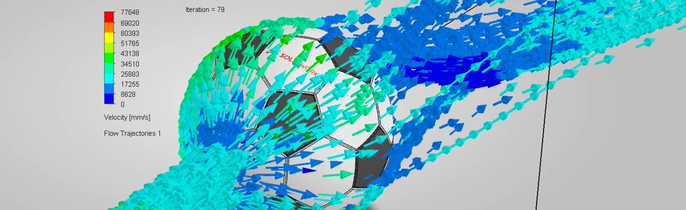

As this was my first CFD project, extracting the data was a massive learning experience. My initial flow trajectories generated arrows across the entire domain, which was too broad.
Finally, generating 3D arrow trajectories perfectly captured the chaotic, turbulent zone of the wake!
