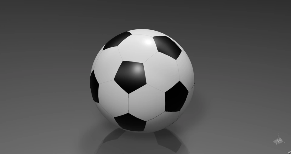

  • Model: FIFA-standard football (diameter: 0.22 m)

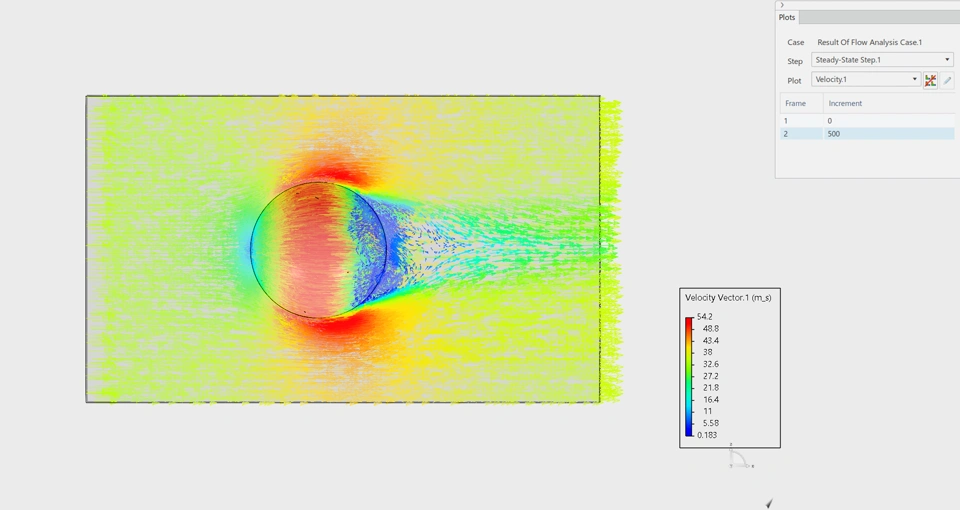

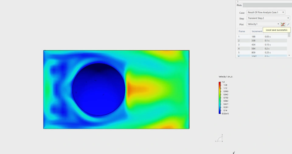

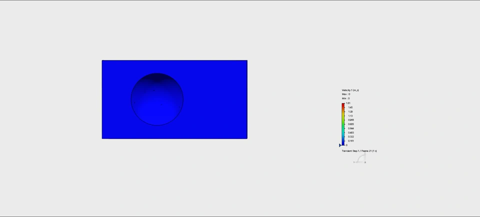

  • Non-Rotating Ball (Knuckleball): Unsteady wake & slight downward lift.

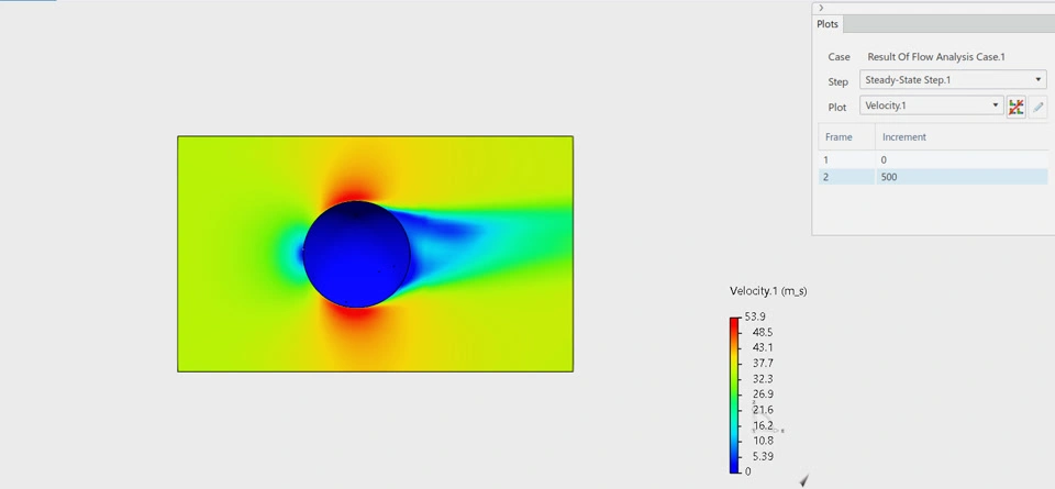

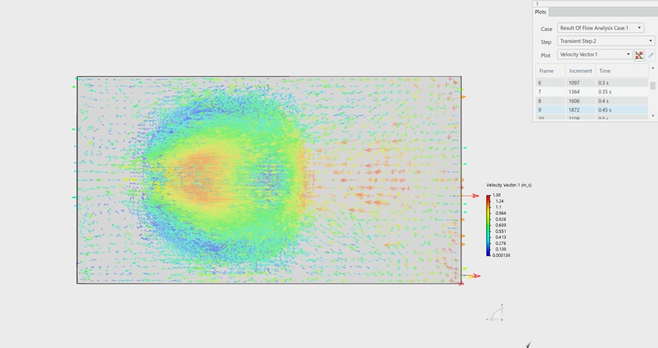

  • Rotating Ball (Spin Applied): Clear Magnus effect with upward lift & curved trajectory.
3D Model:-

  •  Non-Rotating Case: Exhibits unsteady, asymmetric vortex shedding — leading to a fluttery or unpredictable flight path (like in a knuckleball).
  • Rotating Case: Demonstrates the Magnus effect — producing lift in the spin direction, curving the ball in flight.

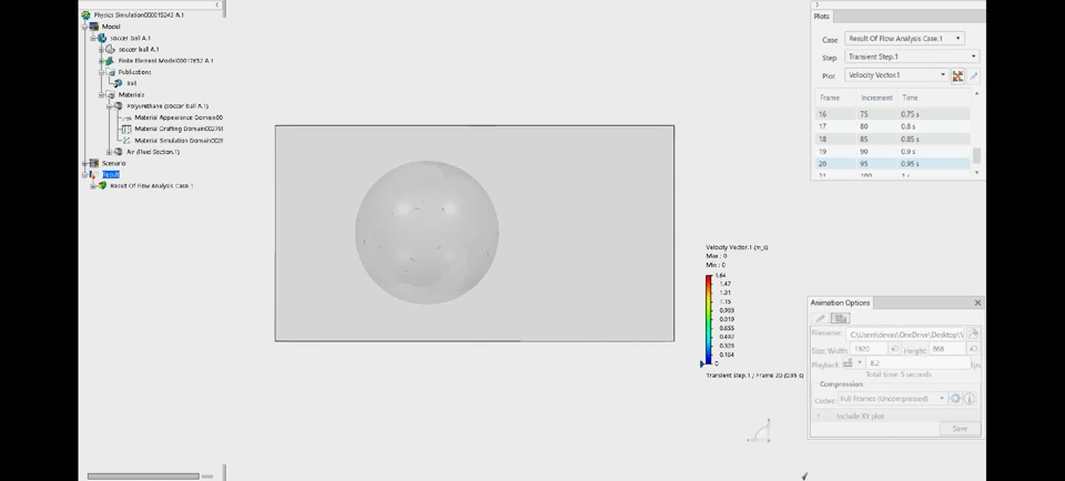

    Roles Used for the following simulation are:-

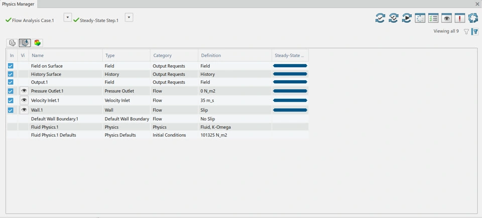

    1. Fluid Model Creation
    2. Fluid Scenario Creation
1. For Non-Rotating Ball
Scenario Properties
Velocity
Velocity Vectors

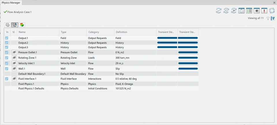

For Rotating Ball:-
Scenario Properties
Velocity
Velocity vectors
