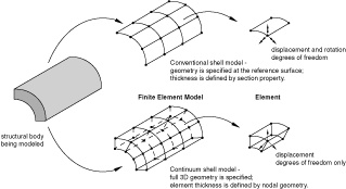

Conventional Shell Versus Continuum Shell
Shell elements are used to model structures in which one dimension, the thickness, is significantly smaller than the other dimensions. Conventional shell elements use this condition to discretize a body by defining the geometry at a reference surface. In this case the thickness is defined through the section property definition. Conventional shell elements have displacement and rotational degrees of freedom.
In contrast, continuum shell elements discretize an entire three-dimensional body. The thickness is determined from the element nodal geometry. Continuum shell elements have only displacement degrees of freedom. From a modeling point of view continuum shell elements look like three-dimensional continuum solids, but their kinematic and constitutive behavior is similar to conventional shell elements.
Figure 1 illustrates the differences between a conventional shell and a continuum shell element.

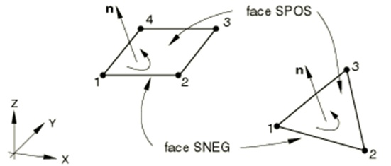

Positive normal definition for conventional shell elements
The “top” surface of a conventional shell element is the surface in the positive normal direction and is referred to as the positive (SPOS) face for contact definition. The “bottom” surface is in the negative direction along the normal and is referred to as the negative (SNEG) face for contact definition. Positive and negative are also used to designate top and bottom surfaces when specifying offsets of the reference surface from the shell's midsurface.
The positive normal direction defines the convention for pressure load application and output of quantities that vary through the thickness of the shell. A positive pressure load applied to a shell element produces a load that acts in the direction of the positive normal.
Three-dimensional conventional shells
For shells in space the positive normal is given by the right-hand rule going around the nodes of the element in the order that they are specified in the element definition. See Figure 2.
Figure 2 Positive normals for three-dimensional conventional shells.

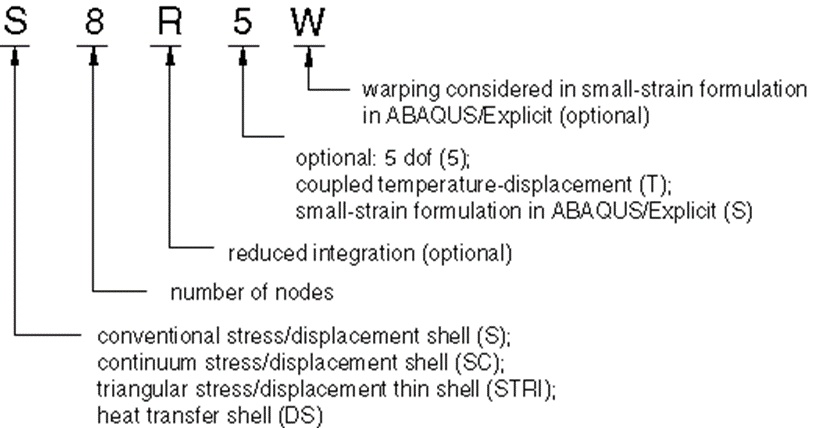

Naming convention
The naming convention for shell elements depends on the element dimensionality.
Three-dimensional shell elements
Three-dimensional shell elements in Abaqus are named as follows:
For example, S4R is a 4-node, quadrilateral, stress/displacement shell element with reduced integration and a large-strain formulation; and SC8R is an 8-node, quadrilateral, first-order interpolation, stress/displacement continuum shell element with reduced integration.

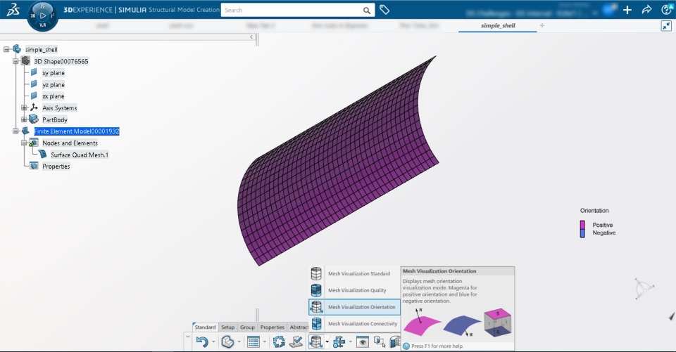

👉 In 3DEXPERIENCE Platform, Mesh visualization orientation can be checked as follows:
