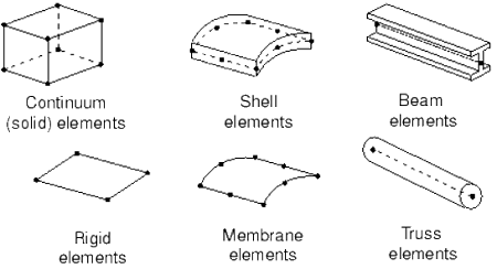

The choice of the appropriate element is very important for the simulation of the physical problem. Element libraries include a wide range of elements that are simple geometric shapes with one, two, or three dimensions.
For example, in case of structural analysis, continuum or solid elements are appropriate for bulky or complex 3D models. Shell elements are suitable for thin parts with thickness significantly smaller than the other dimensions. Beam elements are suitable for structural members where the length is significantly greater than the other two dimensions.
Common element families
