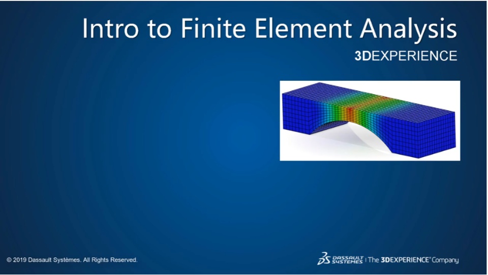

👉 Please check the below video to understand how to perform the above steps in the 3DEXPERIENCE Platform.
📌 To understand more about Finite Element Analysis, please refer to User Assistance.
