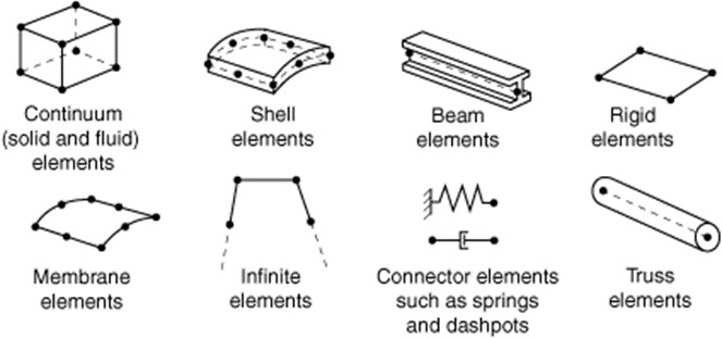

Family
Figure 1 shows the element families that are used most commonly in a stress analysis. One of the major distinctions between different element families is the geometry type that each family assumes.

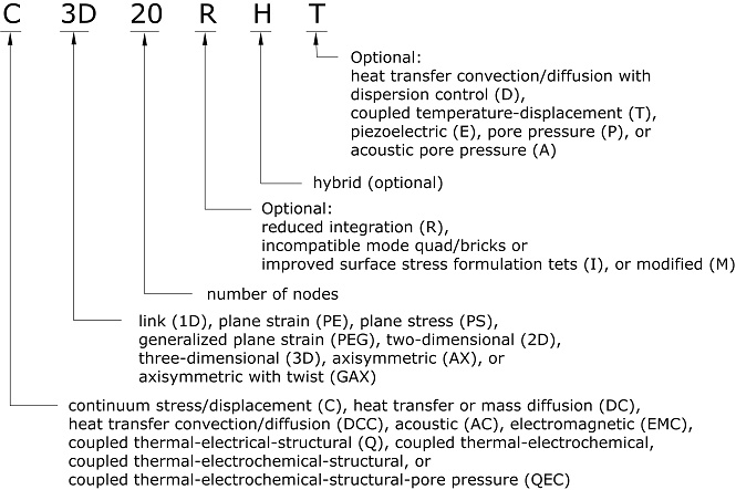

Naming Convention
Each element family is identified by unique naming convention. Please find below naming convention for Continuum elements.

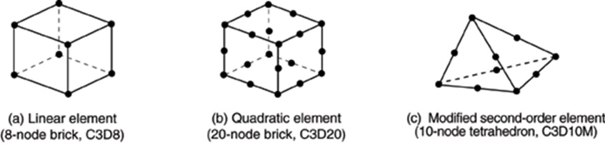

Number of nodes and order of interpolation
Displacements or other degrees of freedom are calculated at the nodes of the element. At any other point in the element, the displacements are obtained by interpolating from the nodal displacements. Usually the interpolation order is determined by the number of nodes used in the element.
- Elements that have nodes only at their corners, such as the 8-node brick shown in Figure 2 (a), use linear interpolation in each direction and are often called linear elements or first-order elements.
- In Abaqus/Standard elements with midside nodes, such as the 20-node brick shown in Figure 2 (b), use quadratic interpolation and are often called quadratic elements or second-order elements.
- Modified triangular or tetrahedral elements with midside nodes, such as the 10-node tetrahedron shown in Figure 2 (c), use a modified second-order interpolation and are often called modified or modified second-order elements.
Typically, the number of nodes in an element is clearly identified in its name. The 8-node brick element is called C3D8, and the 4-node shell element is called S4R.
