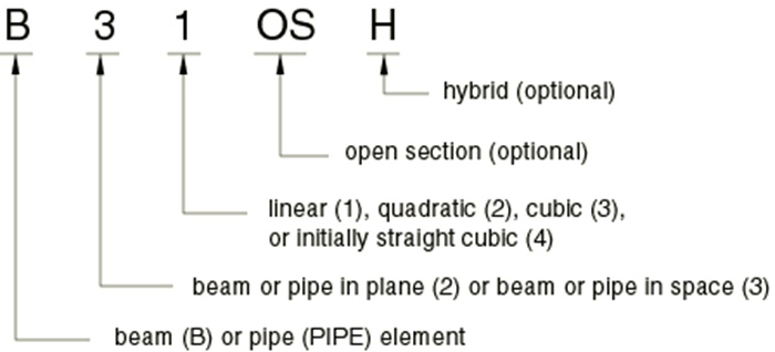

Naming convention
Beam elements in Abaqus are named as follows:
For example, B21H is a planar beam that uses linear interpolation and a hybrid formulation.
