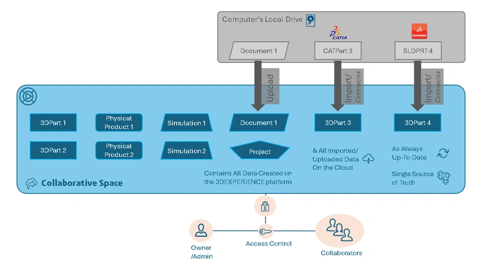

The 3DSpace App allows you to create and manage the Collaborative Spaces (also known as 3DSpaces) on the 3DEXPERIENCE platform.
Think of a Collaborative Space as a secure, cloud-based digital "vault" or "storage area" for all of your data.
It's where ALL THE DATA is actually stored, whether they are CAD models, Simulations, documents, or other types of content!
It's a foundational element that defines how teams work together and what data they can access.
Core Purpose and Functionality:
  • Secure Data Storage: The primary function is to provide a secure and centralized location for all project data. This ensures everyone is working from a single source of truth and helps prevent version control issues, and everyone can access the latest information.

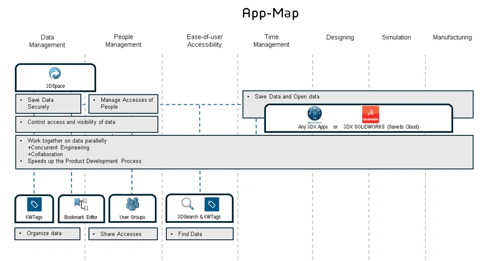

  • Integration: Collaborative Spaces are seamlessly integrated with other 3DEXPERIENCE apps. For example:
    • The Bookmark Editor app helps you organize and create folder-like structures for content that resides in different Collaborative Spaces.
    • 3DSearch allows you to find content across all the Collaborative Spaces you have access to.

It's important to understand the distinction between a Collaborative Space and other apps like the Bookmark Editor:
  • Collaborative Space (3DSpace app): This is the actual storage container for the data. It's the "drive" where your files are saved.
  • Bookmark Editor: This is the tool you use to organize and create shortcuts (bookmarks) to the files stored in various Collaborative Spaces. Think of it as the "folder system" you use to manage your data, regardless of which "drive" (Collaborative Space) it's on.
  • Other Design/Simulation Apps- Whenever data is created, it is stored on a Collaborative Space. Make sure to choose the right Collaborative Space when creating new content from any app.
In short, the Collaborative Space is the foundational "vault" for your data, while other apps like the Bookmark Editor provide the user-friendly interface for managing and interacting with that data. It's the core of the 3DEXPERIENCE platform's data management and collaboration capabilities.
