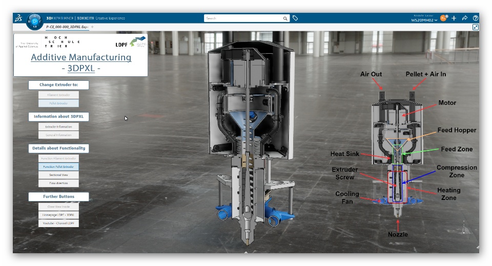

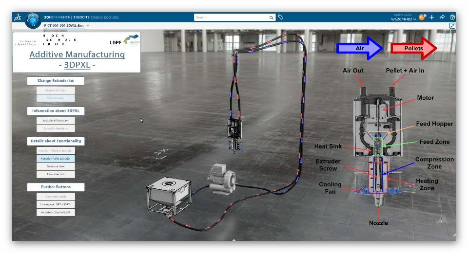

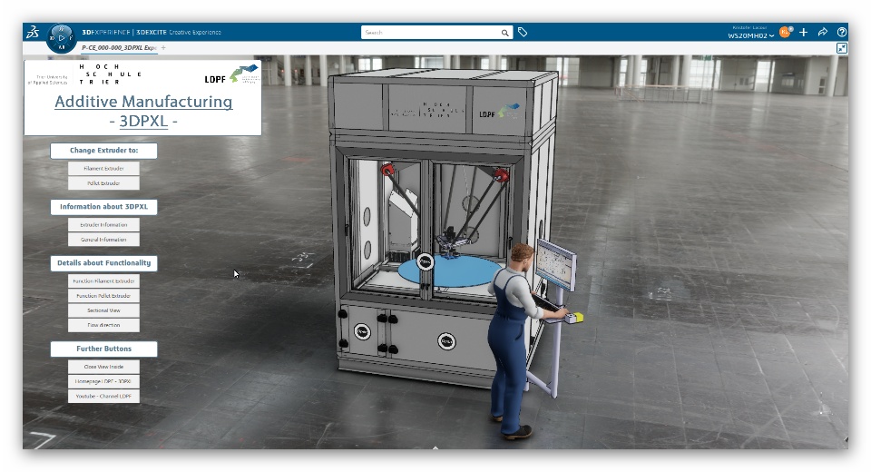

The presented product is the so called “3DPXL”. It is a large-format 3D Printer, which is currently developed in the department of engineering and technology at our university as an experimental platform for project-based learning. It offers the possibility of printing filaments as well as pellets with a temperature of up to 450°C. Therefore, it is capable of printing all common 3D printing materials, such as PLA, ABS, Nylon and PETG.
The goal of my project was to complete the mostly finished 3D representation of the printer to create an interactive experience of the digital twin. The focus was to showcase the different functions of our 3D printer and to give a unique insight into the components and their interactions with each other.

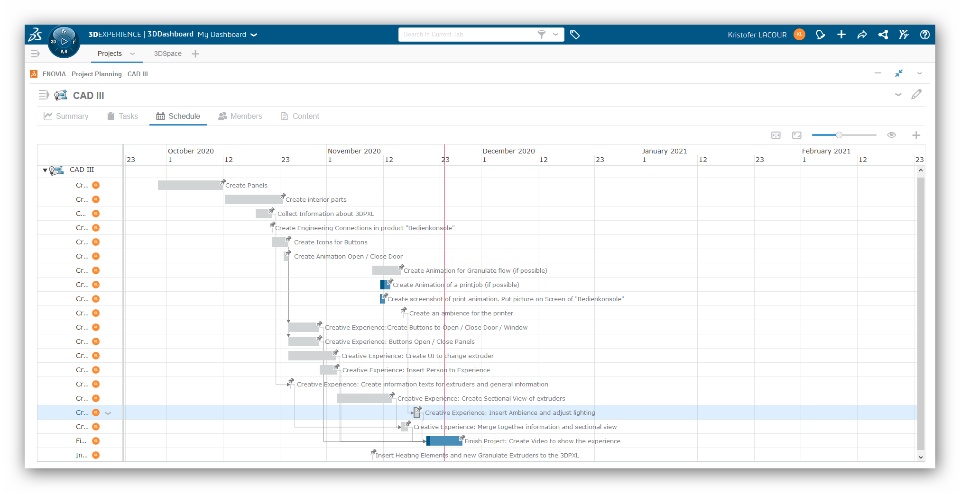

As a first step, I used the app “Project Planning” in my 3DEXPERIENCE Dashboard to gain an overview of every step I need to work on to finish my project intime.
The second step was to create the missing parts in the 3D data like exterior parts, for example the covers, and minor parts on the inside. To create these parts I used the apps “Assembly Design”, “Generative Shape Design” and “Part Design”.

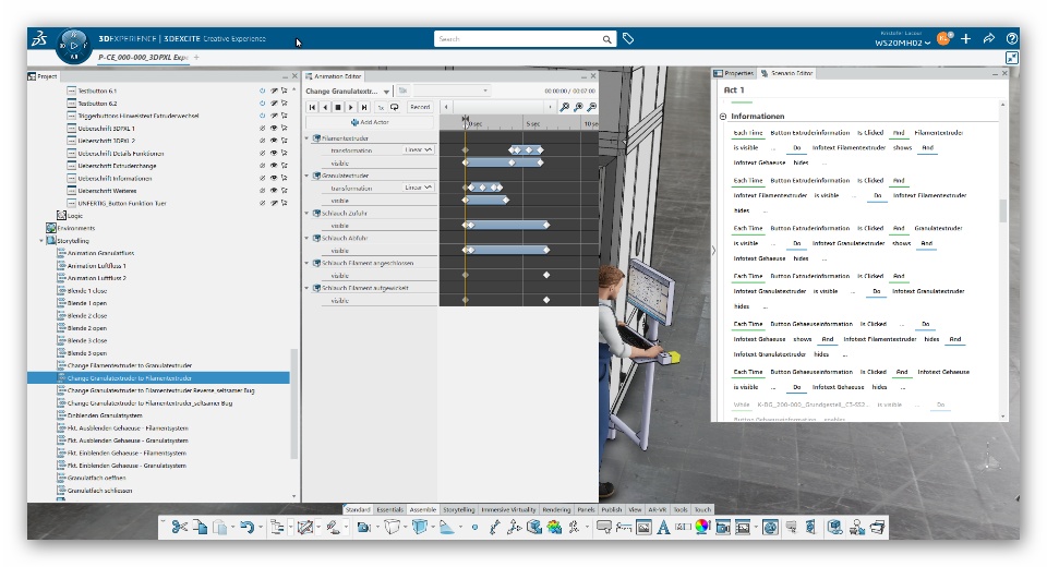

The third step of my project was to create the experience using the app “Creative Experience” and “Human Design”. My focus was on the functionality of the extruders and on creating an intuitive user experience through interactive storytelling.

The big challenges of the project were to create the logic behind the buttons and on the different camera angles and the changes in-between them.
