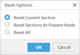

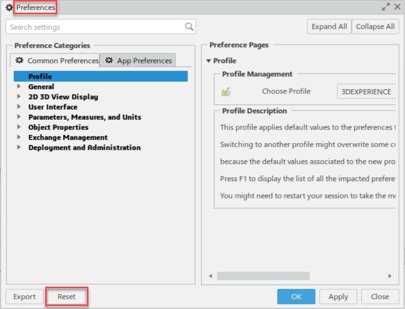

Resetting/Deleting CATSettings files- Clear User Customized Settings
In some cases when a specific function is not working properly, possibly due to improper customization by the user, it can be Reset by the user under Me> Preferences. This is possible from the UI itself, with the reset button.
For resetting the parameter, click the Reset option placed at the bottom left corner of the window. The Reset Options window will pop up as shown below:
The options are as follows:
Reset Current Section: restores default settings for the options under Preference Pages that was last modified.
Reset Pages At Present Node: restores default settings for the options under Preference Pages on the right side of the Preferences dialog box.
Reset All: restores default settings for all options for all nodes belonging to a quadrant or a set of common preferences.
◼ Incase the User needs to start afresh, and if Reset using the UI is not feasible (if you are unable to Launch 3DEXPERIENCE platform due to the incorrect settings), to clear all the stored user customizations, the relevant CATSettings files can be deleted from this folder:
C:\\Users\\\\AppData\\Roaming\\DassaultSystemes\\CATSettings\\
Students may find it useful to reset preferences/ delete relevant CATSettings files if you have incorrectly modified the Settings.
Note: Deletion of these files causes the loss of user customization or preferences.
