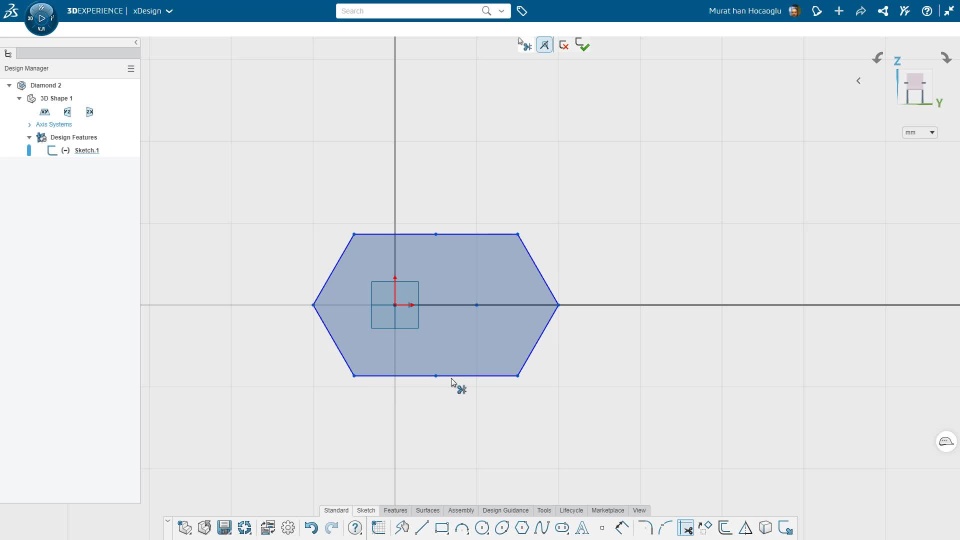

In my current Diamond 2 design video.
I used the CircumcSribed setting instead of Inscribed in the Polygon command because this command would be easier since I wanted to create 2 nested hexagons this time.
Then I used the Trim or Extend command to remove unnecessary places in my design. In this command, I can use it by clicking one by one or by holding it down. If I make a mistake and remove the wrong place while using this command, I can undo it by using the crtl+z command.
Finally, in order to assign materials to my design, I can assign the raw material I want to my design with the Material Browser command from the tools tab.
After all these processes are completed, I can look at my design from different angles by clicking the chair icon on the top right of my screen or using my crtl+mouse wheel.
