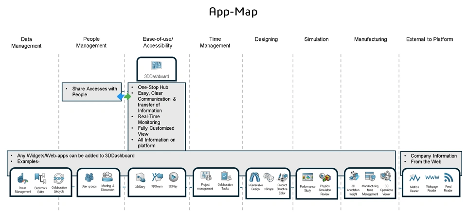

In the professional world, a dashboard is essential for efficiency and collaboration-
  1. A Single Source of Truth: In a large company, different teams work on different parts of a product. The dashboard allows everyone to see a unified, real-time view of the project status.
    For example, a marketing manager can see the latest design update from the engineering team without having to ask for a new file.

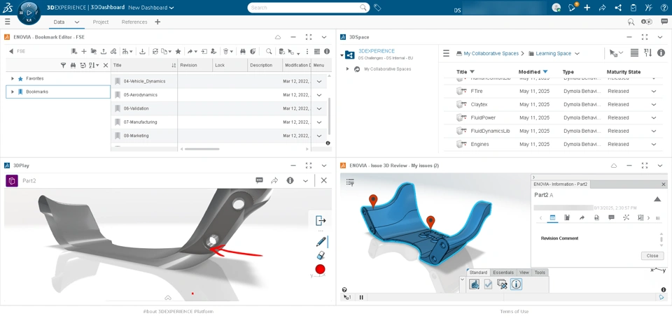

  2. One-Stop Shop for Increased Efficiency: Instead of navigating through different applications to perform different tasks, the 3DDashboard brings all the relevant tools and data to a single location.
    For a mechanical designer for example, this means having the Bookmark Editor for managing files, a 3DPlay for reviewing models, a Project Planner & Collaborative tasks for tracking project progress, and a 3DSwym community feed for team communication & Conversation—all on one screen. This reduces the time spent switching between applications and helps them focus on the actual work.

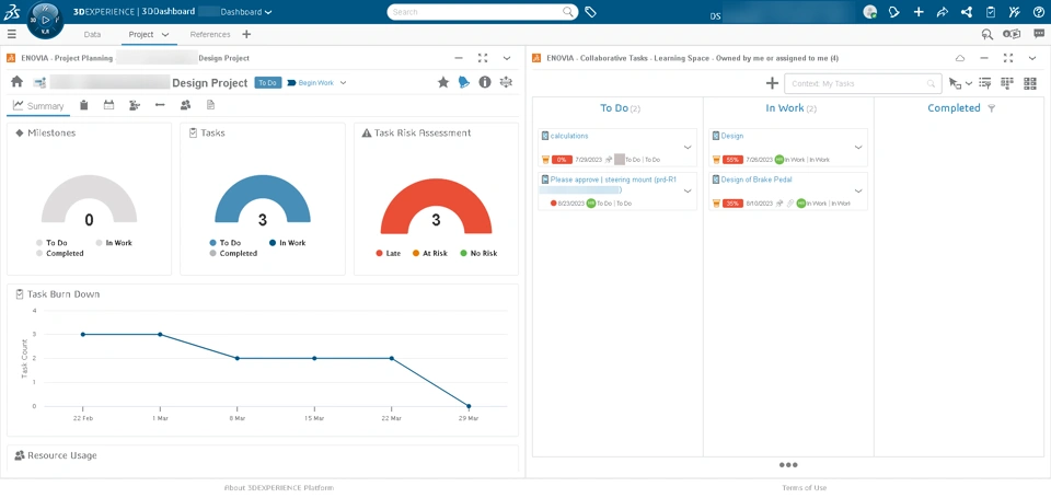

  3. Real-Time Monitoring: Dashboards are dynamic. They don't display static information; they provide live feeds from the platform's database.
    Project managers can set up widgets to track key performance indicators (KPIs) like task completion rates (Project Planning App) or the number of outstanding issues (Issue Management App). This provides instant insights into the project's health, allowing for quick decision-making.
  4. Shared Dashboards: You can share a dashboard with individuals or an entire community. When you share it, the collaborators can see the same widgets and data you do, which promotes a unified understanding of the project.
  5. Enhanced Communication: Dashboards can include social collaboration tools (like the 3DSwym community), allowing team members to communicate and share ideas directly alongside the project data. This ensures conversations are always in the right context.
