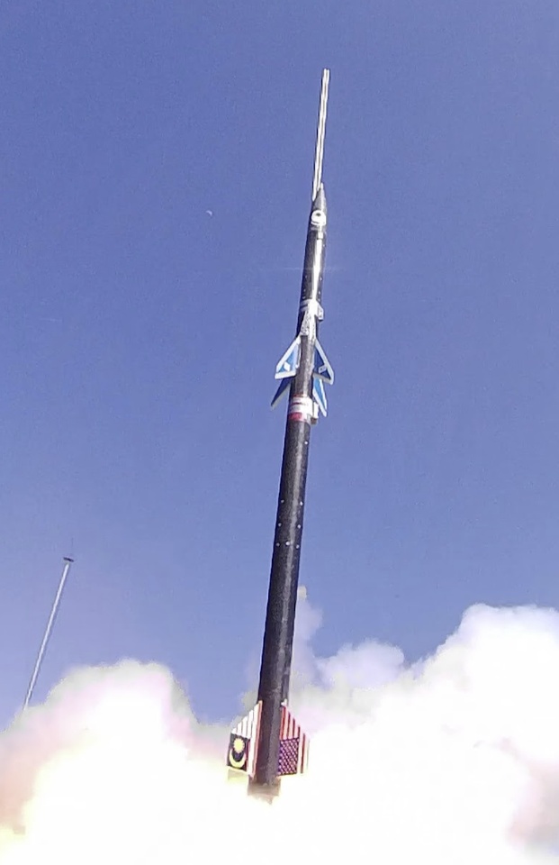

The Kadet lifting off the pad !
After many ground tests for determining the appropriate black powder charge to deploy the parachutes, the project has finally lifted off last weekend at Argonia, Kansas for its first test flight.
The 2 rockets stacked on top of each other, lifted off at 4pm. Approximately 2.7 seconds, the separation charge fired on the interstage coupler, releasing the 2nd stage of the rocket.

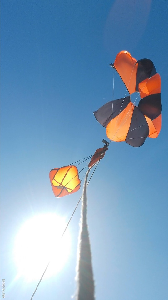

There were some damages to the rocket, but extremely minor. Due to the high sideways velocity at apogee, the 2nd stage's main chute slipped out of its release rubber band, ripped in half, and got deployed together with the drogue chute. It still inflated and landed without any structural damage. The 1st stage deployed it's drogue parachute, but its main parachute did not fully inflate and hit the ground much faster. One of the epoxy fillets on the fins cracked. It has been dremelled off and reapplied.

Damaged parachute on the 1st stage
