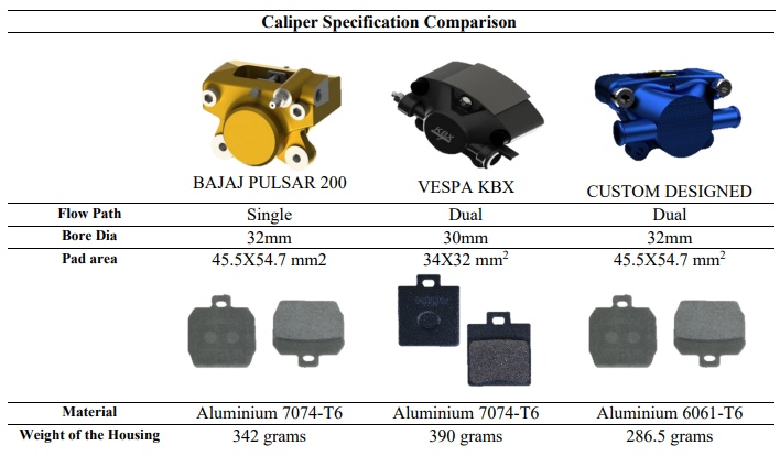

CALIPER COMPARISON
In the following table, we present a comprehensive comparison between our customized-designed caliper and the original equipment manufacturer (OEM) caliper for Bajaj Pulsar 200 and Vespa KBX.
This modeling allows us to examine significant factors such as weight, cost reduction, and design changes that we have incorporated into our customized caliper. By evaluating these aspects, we aim to showcase the advancements and improvements achieved through our innovative design approach. Through this comparison, we can gain valuable insights into the enhanced performance and efficiency of our customized caliper over the OEM counterpart.

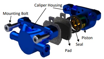

Final Model
We consider the required assembly constraints in the wheel Rim, Flow Path, seal groove geometry dimension, and piston diameter.

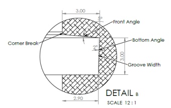

Seal Groove Geometry
The Rubber seal performs 2 main functions i.e. sealing the piston bore and retraction of the caliper piston after the application of the brake, Hence the Design of the seal Groove assembly influences the Braking performance.
