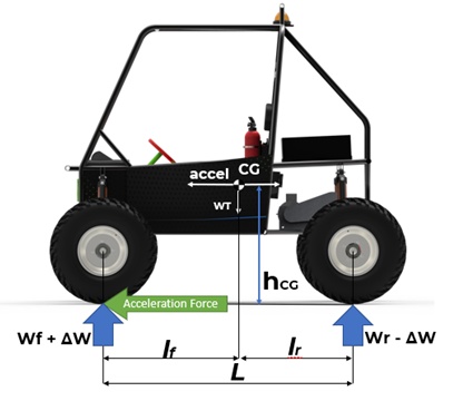

Weight Transfer: During braking, weight transfer occurs as the vehicle's weight shifts from the rear to the front wheels. This transfer increases the load on the front wheels, improving their traction and consequently enhancing braking performance. Understanding weight transfer is crucial for determining the distribution of braking torque between the front and rear wheels.

  4. Height of CG: it is influenced by the distribution of mass within the vehicle. Factors such as the position of the engine, drivetrain components, fuel tank, occupants, and other vehicle systems affect the overall CG height. Typically, the CG is calculated based on the combined weight distribution of all components.
  5. Wheelbase: refers to the distance between the centers of the front and rear wheels of a vehicle. It is a critical dimension that significantly affects a vehicle's stability, handling characteristics, and overall dynamics. Wheelbase plays a vital role in determining the vehicle's turning radius, weight distribution, and ride comfort.

Step 1: Determine the weight transfer during braking.
Weight Transfer in Kg = (Vehicle Weight x Deceleration Coefficient x Height of CG) / Wheelbase
Step 2:Calculate the Static Load.
Static weight on Front wheels in Kg =  (Vehicle Weight x Front Weight Transfer Ratio )
Static weight on Rear wheels in Kg =  (Vehicle Weight x Rear Weight Transfer Ratio )
Step 3: Calculate the Dynamic weight
Dynamic Weight on Front wheels in Kg =  Vehicle Weight + Static weight on Front wheels in Kg
Dynamic Weight on Rear wheels in Kg =  Vehicle Weight - Static weight on Rear wheels in Kg
Step 4: Calculate the Dynamic Load
Dynamic load on Front wheels in N =  Dynamic Weight on Front wheels in Kg x 9.81
Dynamic load on Rear wheels in N =  Dynamic Weight on Rear wheels in Kg x 9.81
Step 5: Determine the Required braking torque
Braking Torque Front in N-m = Dynamic load on Front wheels in N x Radius of Tire in m
Braking Torque Rear in N-m =Dynamic load on Rear wheels in N x Radius of Tire in m
