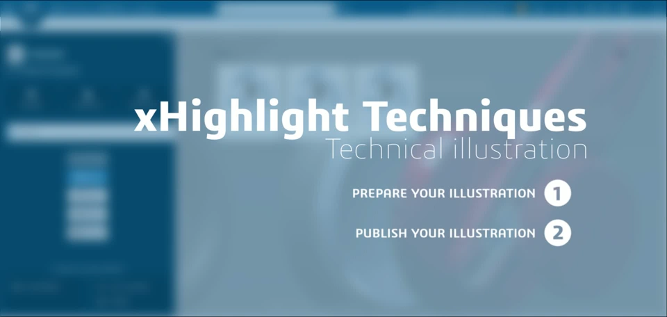

Part 1 : TECHNICAL ILLUSTRATION + INTERACTIVITY
This part focuses on creating interactive technical illustrations directly in xHighlight.
It covers how to prepare and publish the illustration, including SVG-based workflows, while making individual parts interactive.
Topics covered:
  • Technical illustration: Create and prepare a technical illustration directly in xHighlight.
  • Part list & Callouts: Add callouts to highlight and provide information about specific parts in a list of the different parts included in the illustration.
  • SVG Publication: Publish the experience in SVG format to make individual parts interactive to enhance the render.
Video :

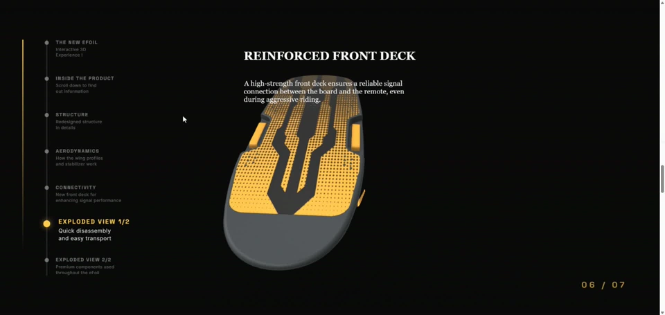

Part 2 : SCROLL NAVIGATION
The second part focuses on the web integration of a completed xHighlight experience.
Once the experience has been fully authored and published, the provided JavaScript code can be used to connect the webpage's mouse scroll behavior to the different scenes of the experience.
Before implementing the scroll interaction, the experience needs to be correctly prepared in xHighlight. The scenes should be properly structured, with their transitions and timing adjusted to ensure smooth progression when moving from one scene to another.
Live example of scroll navigation with implemented code :
CODE EXAMPLE:
Once the Experience Media has been initialised, the following steps show you how to retrieve the available scenes and connect them to the webpage scroll.
BEFORE THE WORKFLOW : REQUIRED SETUP 🔧
What it does: Sets up the variables and scroll container required to connect the webpage scroll to the xHighlight scenes.
