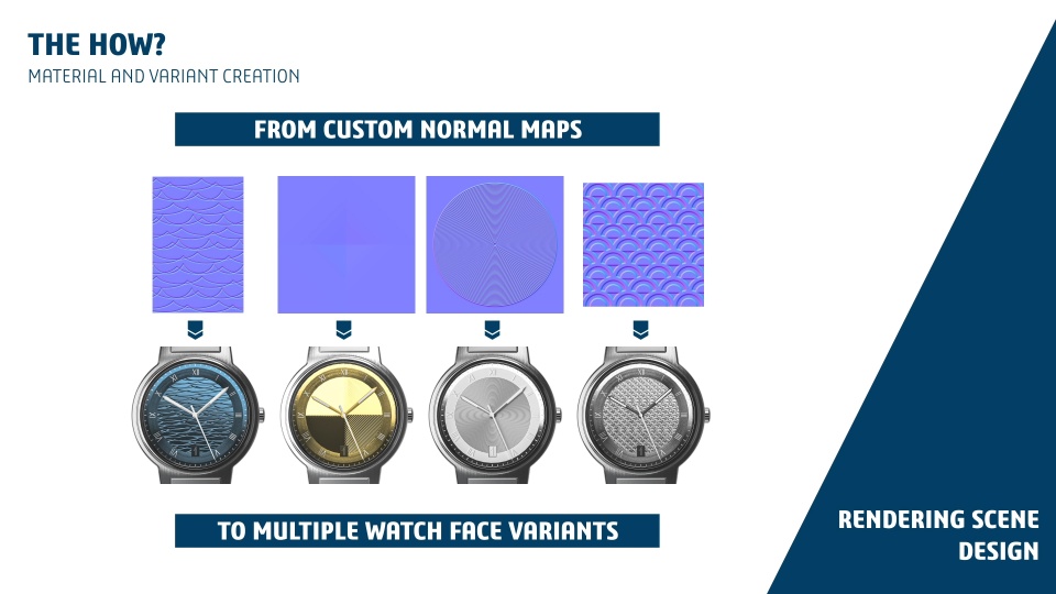

1 | Creating textures from black and white to normal map in Photoshop
Based on reference pictures I created multiple textures which would then resemble watch face patterns once applied to the material. To create a normal map, I first designed a black and white map aka a bump map: black is the lowest point and white is the highest point. The different shades of grey determine the transition between these points. It is possible to use this map with the PBR (Physically Based Rendering) 3DS Enterprise material available on the platform. However, a normal map holds more information and as it is easy to convert a bump to a normal map in Adobe Photoshop. (You can find plenty of tutorials online on how to create normal maps in Photoshop.)
Note: normal maps are often saved as .tiff, but this is not supported (yet). Use a .png instead as it is lossless.

2.1 | Rendering Scene Design application
After creating these textures, we can add them to the material in Rendering Scene Design. We can add variants by duplicating geometry and adding a unique material to it. At this moment, it is not possible to switch materials on one geometry. In regards to applying materials, it is advised to use PBR material with Covering type. The other option, core material, is usually used as test / stress materials. Covering materials on the other hand are added neatly underneath the scene tree in a separate material parent. From the material name in this parent you can see which material it is and on which geometry it is applied on. Finally, you can also add materials on different levels, I usually apply it on the ”white stairs” sub-level. Both material types can be assigned on any of the levels.
Note: make sure that each material is linked to a piece of geometry so all of them are saved to your material library.

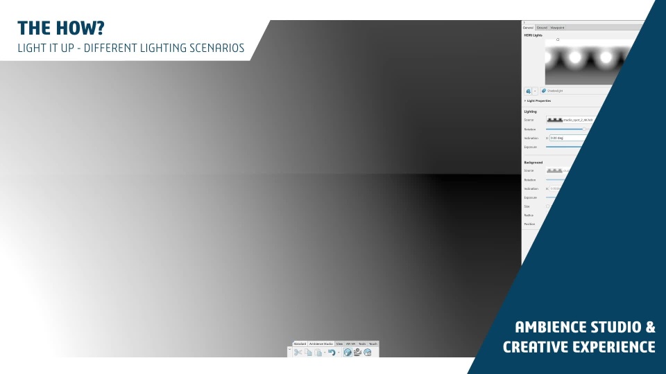

2.2 | Ambience Studio application
I would advise to open Creative Experience first and import your model (with your materials and variants from Rendering Scene Design). Once open, you can click on the compass again and go to Ambience Studio. Thus, both apps can be launched and opened at the same time. This is possible for any app, as long as your system can cope with the performance demand. The advantage by having both apps open, is to be able to let them interact with each other as they will sync once one of the app projects is saved. Example: add a custom hdr or start from any of the preset Ambiences, save the Ambience and then go back to your Creative Experience. Once you have added your Ambience to your Creative Experience project, they are linked up. So, any time you change anything in Ambience Studio such as the rotation or exposure, these changes will transfer over to Creative Experience once you save.
Note: change the size of your Ambience to finite if you would like to adjust the rotation in Creative Experience as well. Otherwise, these parameters will not be exposed in the properties tab of the imported Ambience in Creative Experience.
Note: make sure to use hdr files with a resolution with the power of 2.

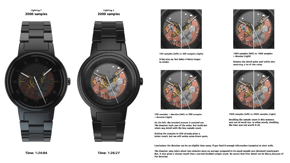

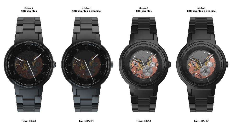

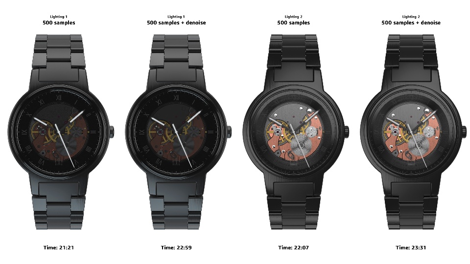

In regards to the denoiser, here is an overview of a sample test I did with this particular watch project. Each render was rendered with Stellar on a 4k resolution.
Note: pay attention to the conclusion on the last image of this test. Although logical, it is very handy to know!
Note: in the render settings, you can find the denoiser setting in the miscellaneous tab.

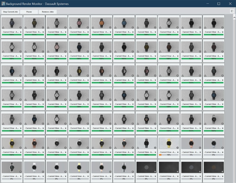

Finally, render batching. You need to record your scene as a Stellar file in order to start the rendering process. You launch a recording by either clicking the render image button (image) or use the Ctrl-alt-b shortcut. The recorded scene then gets send to as a rendering task to the Background Renderer. You can see your task queue in the Background Render Monitor:
You can restart, adjust settings, stop and rearrange render jobs within this monitor. You can also see some render info when you hover over the “I” icon such as time and sample count. There is also a status bar and to save, simply click on the left icon with the arrow.
Note: Stellar recordings are stored on your pc locally or on the server hard drive. Locally, it is stored in CATTemp < BatchRendering < Cache < Stellar folder. Do clean this folder from time to time as these files add up very quickly!
Note: as the name suggests, this monitor renders in the background, so you can continue on adding recordings while they are being rendered sequentially.

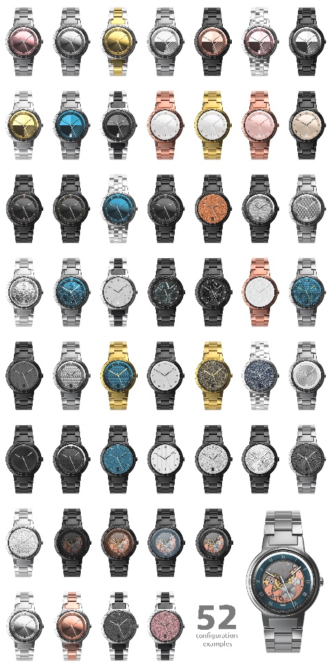

5 | Overview
This is an overview of all of the configurations I made renders of in the full front angle. All of these were loosely based on existing watch models, adding my own spin to it:
