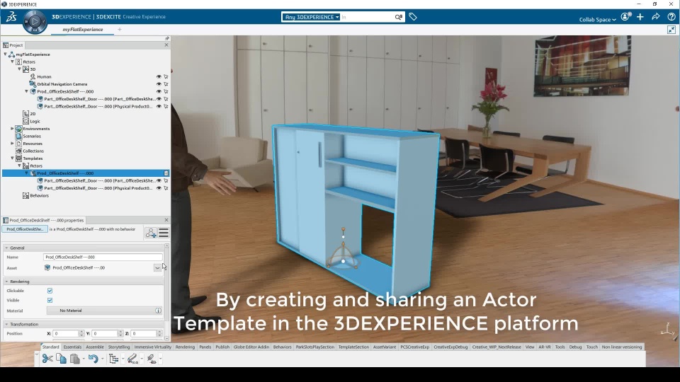

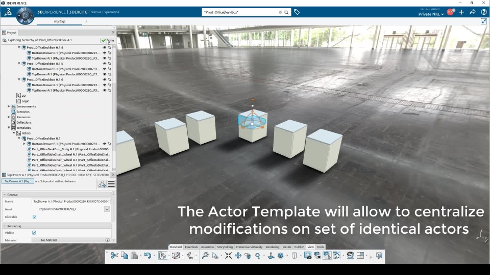

The abilities offered by the Actor Templates are multiple:
1) Facilitate Experience Design
- Marketing Experience Artist will be able to centralize creation and modification of numerous identical actors
- Marketing Experience Artist will be able to share smart actors between experiences
2) Allow Creation of Modular Experiences

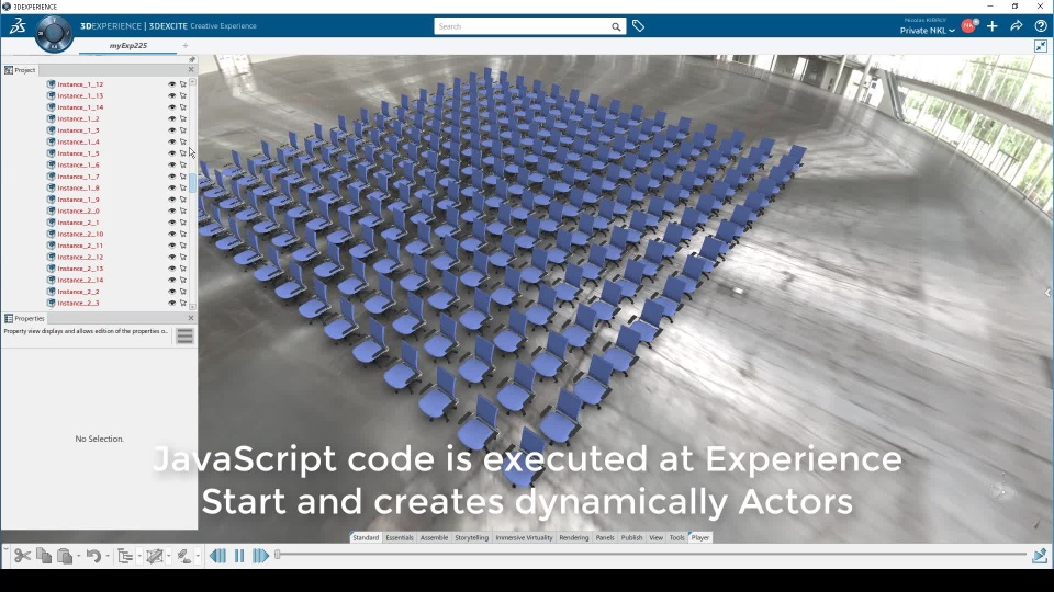

- This tutorial deals with the advanced feature of actor template for dynamic actors creation at runtime. It requires basic knowledge of Creative Experience Application and JavaScript scripting.

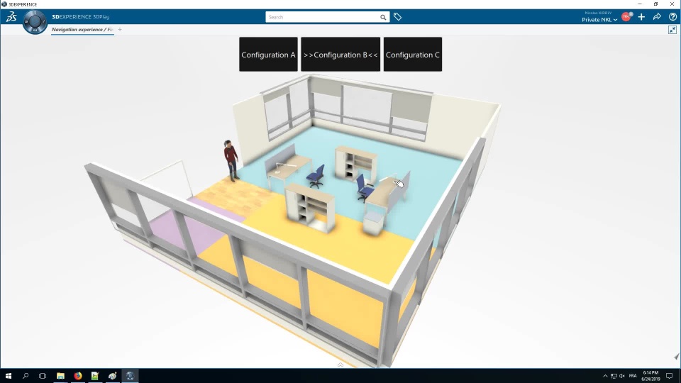

- The following hands-on exercise presents you how to use dynamic actors at runtime, illustrated through a scenario of office space layout, as an example.

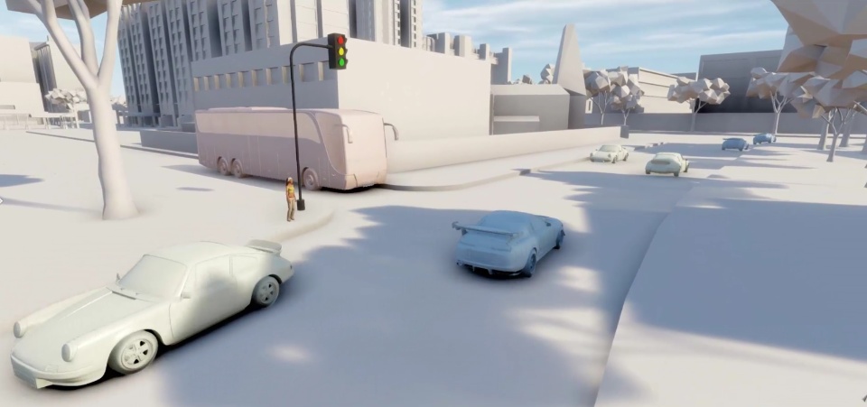

- "Traffic Manager" behavior, which uses actor templates to dynamically generate the cars

- Experience Play => Marketing Experience Reviewer
- Switches between several layouts
- Navigates in the scene
