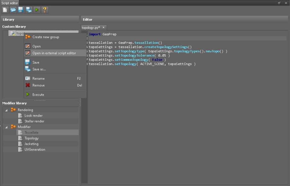

The direct execution in DELTAGEN is best suited for developing and testing. Via the built-in script editor, you can easily write and run your scripts. The provided code snippets help to understand how the basic functions will be used. In your custom library, you can organize your scripts in virtual folders.

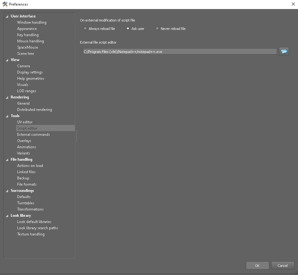

Expert users probably prefer to use a more advanced editor. Therefore, an option in the context menu has been introduced to open a script in an external editor. The editor of choice can be defined via the preferences.
Script editor preferences
Open in external editor​​​​​

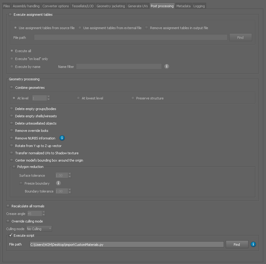

A second alternative for executing python scripts is available in the DELTABATCH configurator: You can specify a script, which is applied for every file that is processed. As usual, the conversion is done using the provided parameters. Before the converted file is written to disk, the passed script is executed. Like this, you can add custom behavior, which goes beyond the fixed pipeline defined by DELTABATCH.
Python script as Postprocessing step in DELTABATCH Configurator

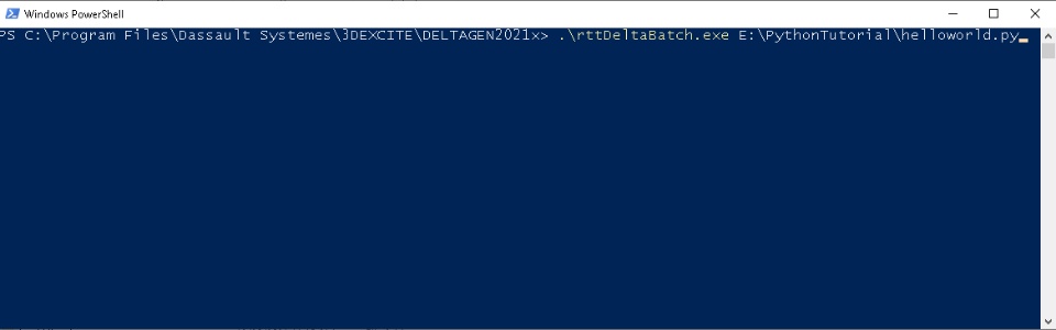

Full flexibility is given if the entire pipeline is described via a python file. It is executed by passing the path to the python script as command line parameter to rttDELTABATCH.exe. Since DELTABATCH is a console application requiring no user input, it can run overnight in the background or on dedicated server machines.
A python script passed to DELTABATCH via the command line
