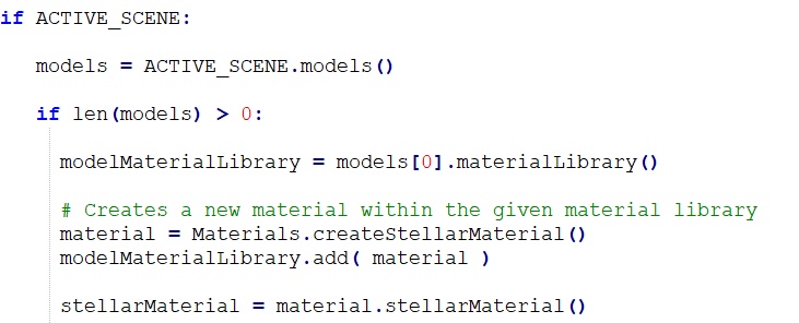

Let’s assume we have an open scene and want to add a Stellar material to the model look library:
At this point in our script, we have access to the actual Stellar RenderMaterial. There are no dedicated methods for accessing all of the contained parameters. Instead, a JSON object can be retrieved, which holds the parameters of the material:

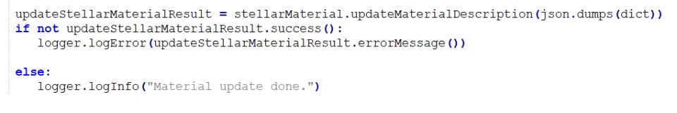

After having applied all changes to the JSON object, just update the material description:
Now we can see the correctly applied albedo color in the UI. Please consider that we have set the RGB color in linear colorspace. This is why need to switch to this colorspace in the UI as well to see the same values:

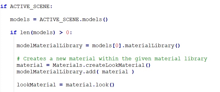

Working with look materials does not significantly differ from the workflow with Stellar materials. First, we need to get the actual RenderMaterial of the Look:

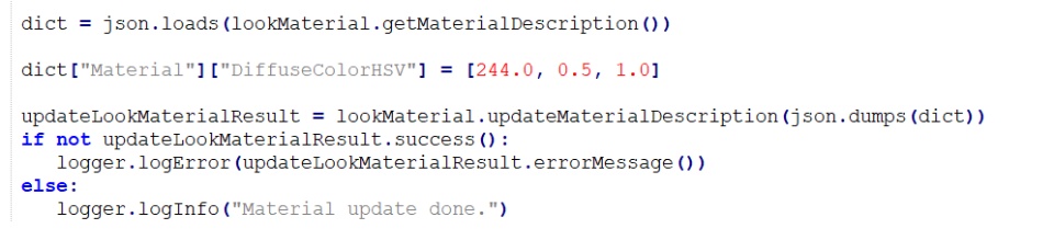

Afterwards, we access the parameters via the JSON object, which we initialize with material description:
We changed the diffuse color by passing the hsv values of the color. The hue needs to be specified in the range from 0 to 360, and saturation and value must be in the range from 0 to 1. Hurray, we are done!

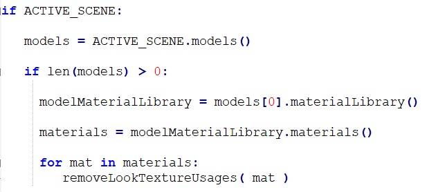

Let’s write a script! First, we need to traverse all materials in the Model library of the active scene and call a helper function “removeLookTextureUsages” for every material:

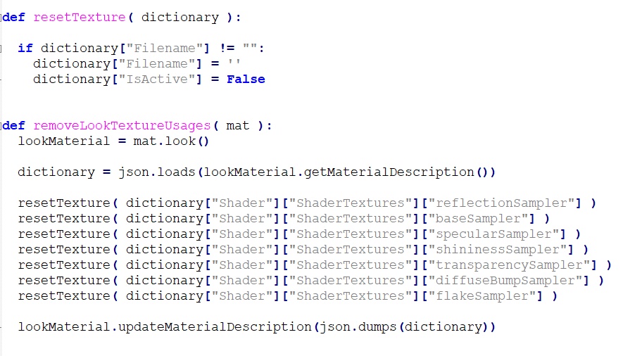

Let’s inspect this helper function: It accesses, like in the previous examples, the JSON description of the material. All subdictionaries for the texture samplers are passed to the resetTexture function. This clears the file name and sets the “IsActive” property of the sampler to False.
That’s it!
