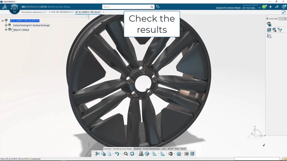

In today's release, I’ll guide you through how to split bodies in a 3D model for easier material application.
Here's what you'll learn:
- Identifying the geometries that need to be split into new products, making them ready for material assignment.
- Preparing the xOptimize split shape operation by level.
- Running the xOptimize split shape operation.
- Setting up the xOptimize material assign operation using the property selector V_Name.
- Running the xOptimize material assign operation.
