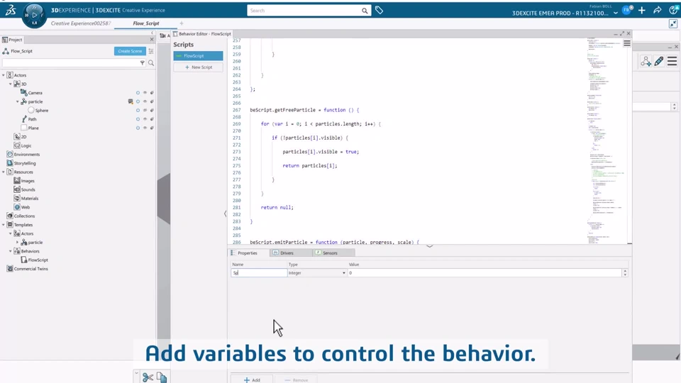

Hi and welcome to the next Quick Tip of this week!
In this video I show you how to use the script "SimpleFlow" with a simple scene inside CreativeExperience .
You can use this script for example to simulate objects on a conveyor belt or for any object that should follow a path with a certain amount of objects.
Please copy the script here:
