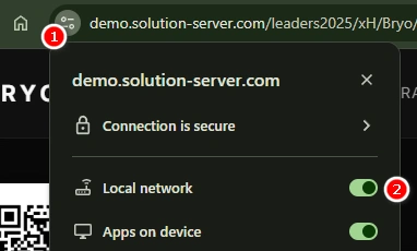

🔧  Remember to enable your local network settings when arriving at the website in Chrome :
LIVE EXAMPLE :
https://demo.solution-server.com/leaders2025/xH/Bryo/

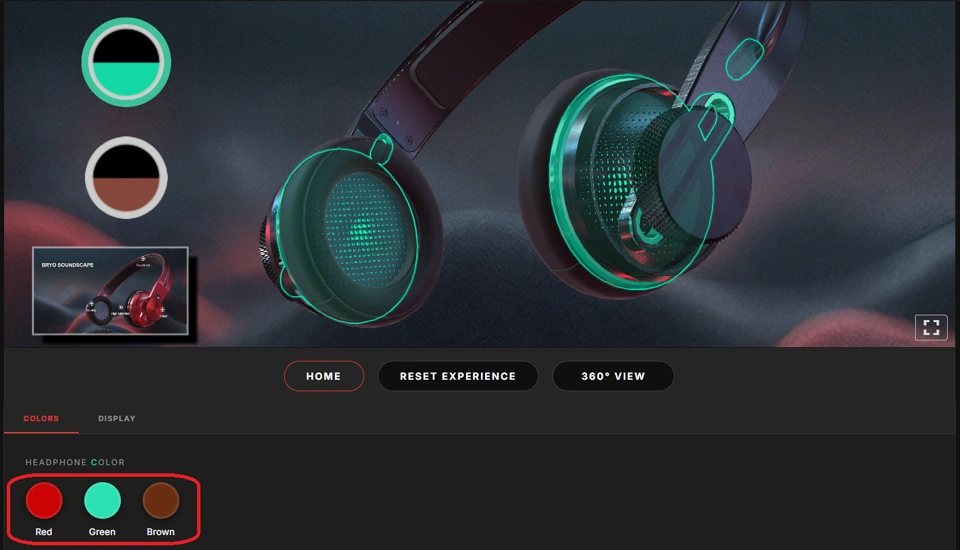

N°1 - Custom BUTTONS to go to the main scene, reset the experience and see a 360° animation.
N°2 - Custom TABS to slide between colored scenes and display settings.
N°3 - Custom COLORS in the colors tab, that go to a specific scene for each.

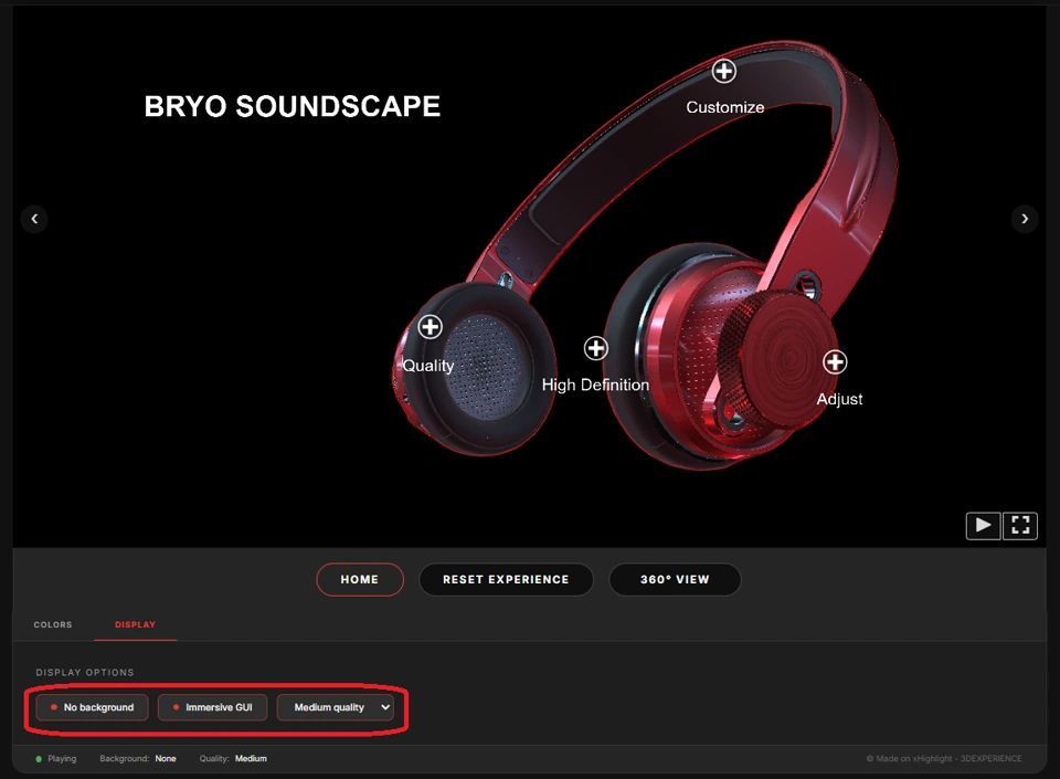

N°4 - Custom INFORMATION to see that the Experience Media is playing, the background, and the quality settings.

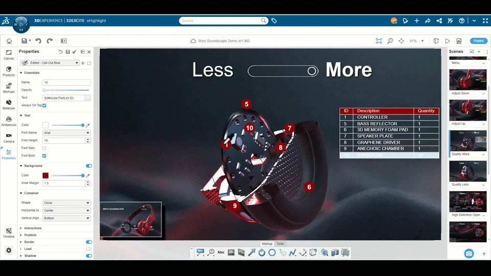

Step 1 - Using xHighlight
Build your experience
  1. Import your 3D model or Open your product into xHighlight.
  2. Set up scenes: define camera positions, part visibility, and environment for each state.
  3. Create animations: use the timeline editor to easily set animations and transitions.
  4. Add interactive hotspots or annotation overlays if the experience includes guided exploration.
  5. Configure highlight or material variants for product personalization features.
  6. Test all scenes and animations in xHighlight's built-in preview mode at any time.
Measuring scene duration
To determine the exact duration of a scene animation (required for the web timer-based pause):
  1. Open the scene in xHighlight.
  2. In the bottom panel, open the Timeline.
  3. The total duration is shown at the end of the timeline bar and can be modified with this icon:
  4. Note this value it will be used as SCENE_ANIMATION_DURATION in the website JavaScript.
🗒️  Note: always record the duration in milliseconds. The web integration uses a timer set (duration – 0ms to 500ms) to pause just before the natural scene end.

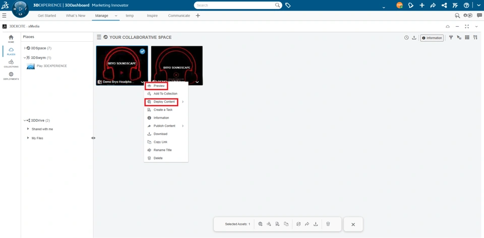

Step 2 - Using xMedia
Finding your published experience
  1. In the left panel in xMedia, click "Places".
  2. Under 3DSpace, select this project Collaborative Space ; your experience must appears in the Work Area.
Deploying the experience
🗒️  Note 1 : you must have the rights to manage deployments to do this step. Contact your Admin to grand you access
🗒️  Note 2 : you must have your server registered within xMedia authorized list. Contact your Admin to authorize it
  1. Select your experience, and click "Preview".
  2. Select your experience, and click "Deploy Content" :
  3. Click on "Web Deployments" and wait for the confirmation notification. The deployment now appears in the Left Panel under Deployments → Website Integrations.

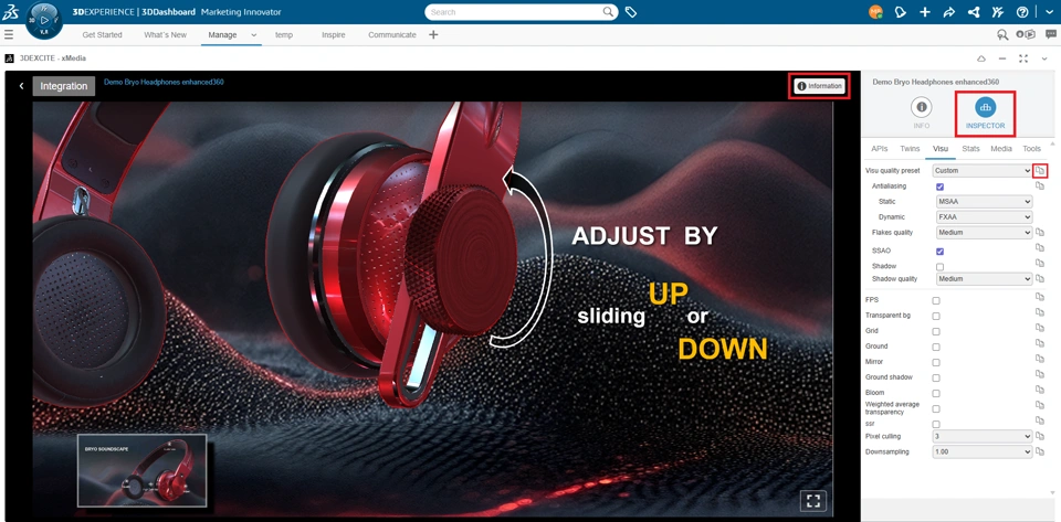

Getting the embed credentials
  1. In the Deployments panel, select your deployment and click "Integration Documentation" from the flyout menu. You are directed to the Experience Player Documentation page.
  2. You can choose between Static Instantiation (using HTML Tags) or Dynamic Instantiation (using Javascript). Click "Generate full HTML". This downloads a file called "index.html" to automatically fill your experience in your code.
🗒️  Note : every republish from xHighlight to xMedia generates a new model path. Always retrieve fresh credentials after each republish and update the model attribute in your HTML.
How to interact with the player (getting your scenes ID and functions)
The inspector provides useful commands to communicate with your player and experience.
  1. In the Deployments panel, click on your deployment and click "Preview". Once the Media Experience is loaded, click on "Information" at the right-top and click on the "INSPECTOR" tab.
  2. In the Inspector, you can copy functions from sections “Tools”, “Visu” and “APIs” where all scenes are listed, using the icon at the right of each scene/toolbox/button.
For example:
- For the GUI Visibility, you will have in your clipboard "playerWebComponent.xHvisibilityImmersiveGUI(false);" (Tools)
- For a transparent background, you will have in your clipboard "playerWebComponent.setTransparentBg(undefined);" (Visu)
- For a scene, you will have in your clipboard "playerWebComponent.xHplayScene("YOUR SCENE ID");" (APIs)

Example for color swatches :
<i><div class="swatch-row"></i>
<i>               <div class="swatch-item"><div class="swatch" style="background:#c90404" onclick="goSceneByName('color1',this)"></div><span class="swatch-label">Red</span></div></i>

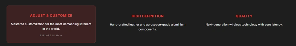

  2. Feature cards on click navigation 🖱️
    Feature cards trigger direct 3D scene navigation. Clicking a card scrolls the user to the player and loads the relevant scene:
    <i><div class="feature-card" onclick="goSceneByName('YOUR_SCENE_NAME'); scrollToPlayer()"></i>
    <i>   <h3>Feature Title</h3></i>
    <i>   <p>Feature description text.</p></i>
    <i>   <p class="explore-hint">Explore in 3D →</p></i>
    <i></div></i>
  3. Color swatch navigation 🎨
    Color swatches navigate to a dedicated scene per variant. Passing this as the second argument to goScene() lets the function highlight the active swatch:
    <i><div class="swatch" style="background: #c90404" onclick="goSceneByName('YOUR_SCENE_NAME', this)"></i>
    <i></div></i>
DISPLAY TOGGLE PATTERN 🧰
Here you can use the function given from the xMedia inspector (Tools / Visu) and implement it the way you want.
Another way is to set functions like this to enable/disable functions via buttons or something else:
<i>function toggleGUI() {<!-- --></i>
<i>   isGUIVisible = !isGUIVisible;</i>
<i>   P()?.xHvisibilityImmersiveGUI(isGUIVisible);</i>
<i>   document.getElementById('tog-gui').classList.toggle('on', isGUIVisible);</i>
<i>}</i>

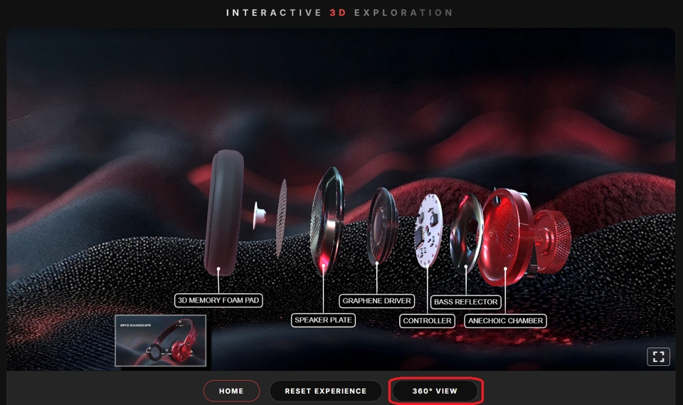

ANIMATED PLAYBACK FOR A 360° PATTERN (with timer-based pause) 🕧
Variable declaration :
Duration (in milliseconds) of the animation, as measured in xHighlight's timeline panel. The auto-pause fires at exactly this time, just before xHighlight would automatically advance to the next scene. The timer intercepts it (workaround⏳  until there is a specific API). SCENE_360_DURATION must be measured manually in xHighlight's timeline and updated after every animation modification.
<i>const SCENE_360_DURATION = *****;</i>
<i>function play360() {<!-- --></i>
<i>    const p = P();</i>
<i>    if (!p) return;</i>
<i>    const scene = globalScenes.find(s => s.name === "YOUR_SCENE_NAME");</i>
<i>    if (!scene) return; // Safety guard</i>
<i>    clearTimers();</i>
<i>    document.querySelectorAll(".swatch").forEach(s => s.classList.remove("active"));</i>
<i>    // Skip re-navigation if already on the 360 scene to avoid the xHplayScene. re-trigger glitch; navigate only when coming from a different scene</i>
<i>    const playAnimation = () => {<!-- --></i>
<i>        p.xHplay(); // Start the animation</i>
<i>        // Schedule the auto-pause to fire just before the natural end</i>
<i>        pauseTimer = setTimeout(() => {<!-- --></i>
<i>            p.xHpause();</i>
<i>            pauseTimer = null;</i>
