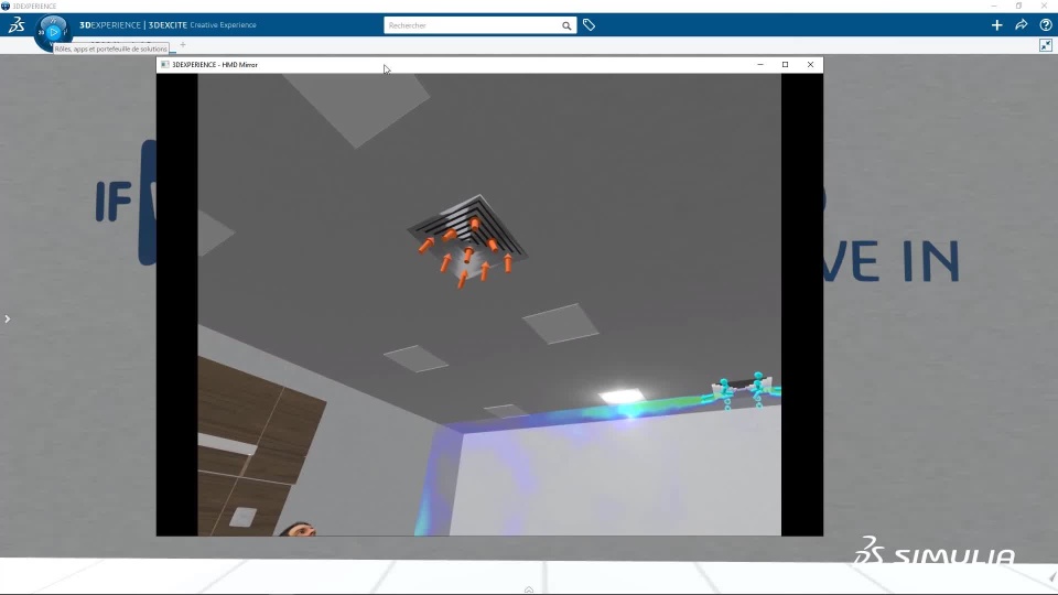

Hello, I am glad to release my 2nd Demo, built in Creative Experience. This one meant to be immersive (VR). The goal of this study is to understand different ventilation scenarios inside a Hospital room. The patient is sick and emits particles when coughing. According to ventilation set up : how can those particles be extracted quickly to keep the medical staff safe and to clean the air.
Simulation enabled to reveal the world we live in, by making visible the insivible, to better mitigate the risks related to airborne pathogens.
- Based on existing demo developed by Guillaume on AR platform ( Ipad version + Hololens version), this demo was built to show 3DX platform capabilities and communicate throughout the platform.
- Geometry model was prepared in 3DEXCITE Deltagen and imported as 3XF on 3DX.
- Simulation results were extracted from PowerFLOW results into simOjbect ( lightweight results) using PowerBy.
- Patient is from Human library.
- Scenario script is done with existing bricks. No customized script.
